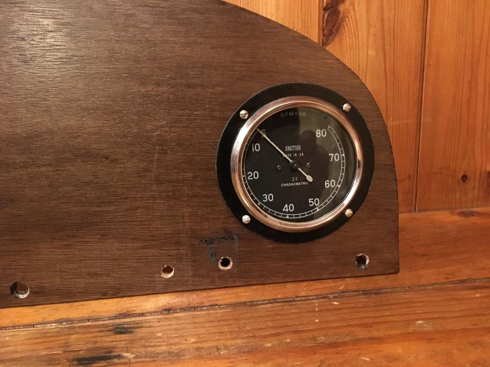

Mechanical drive off the bottom of the distributor.  Although it says 2.1 on the dial in fact it read too fast and I’ve scanned and reprinted the dial. Only reads to 4000 now  Sad.
