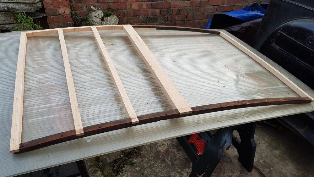

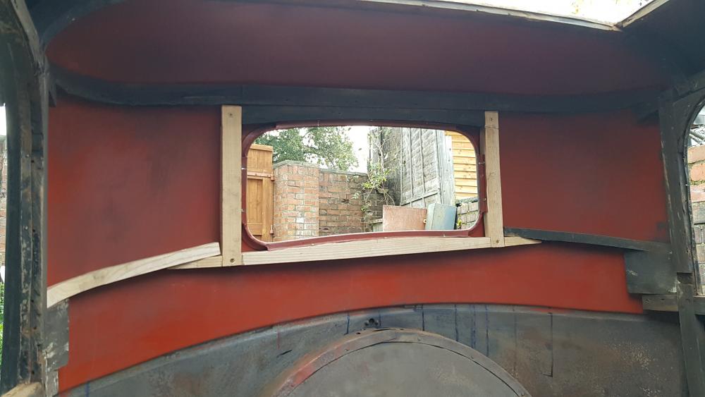

        Having resorected my restoration of my ARQ Ruby, the running gear was actually finished a good eight years ago! and the car sat waiting for me to start again and finish it I replaced the rotten and broken sections of timber framing.
Nice work Tom...watching with interest and an admirable retention of the original timbers.
Thanks having now pretty much stripped the car if is nice to see if moving forward! By the way the templates I prommiced are sitting in an envelope just waiting to be posted.
