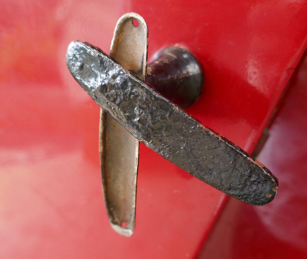

Not a bodge - but how does a Chummy door handle get into this state? Not only rusty, but flattened as well.

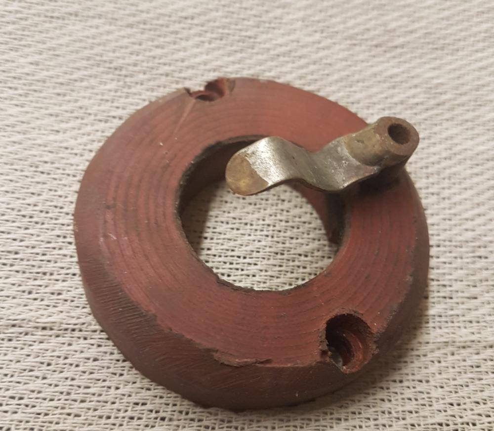

(18-10-2020, 03:30 PM)Steve Jones Wrote: Not a bodge as such but a repair to an insignificant issue that caused more damage than the issue it was trying to repair!
This was a definitely a bodge.
It's the rotor arm of an ML RF4 magneto, remanufactured from wood with a brass strip screwed on.
The mag came from Australia where the climate may have been more tolerant.
