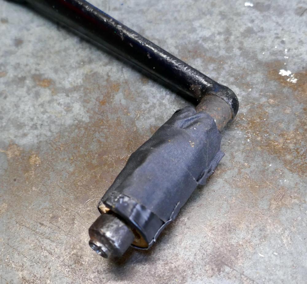

Happily, while the chassis and engine all appear solid, my new acquisition of an old flame has brought to light some horrific short-cuts. We should start a thread on "Desperate Bodges". Here's one, the starting handle with a superbly-crafted replacement for the brass sleeve - two bits of wood lashed together with insulating tape. OK, I'll hand it to the previous owner, he did use a vintage style of tape, not the modern stuff.
