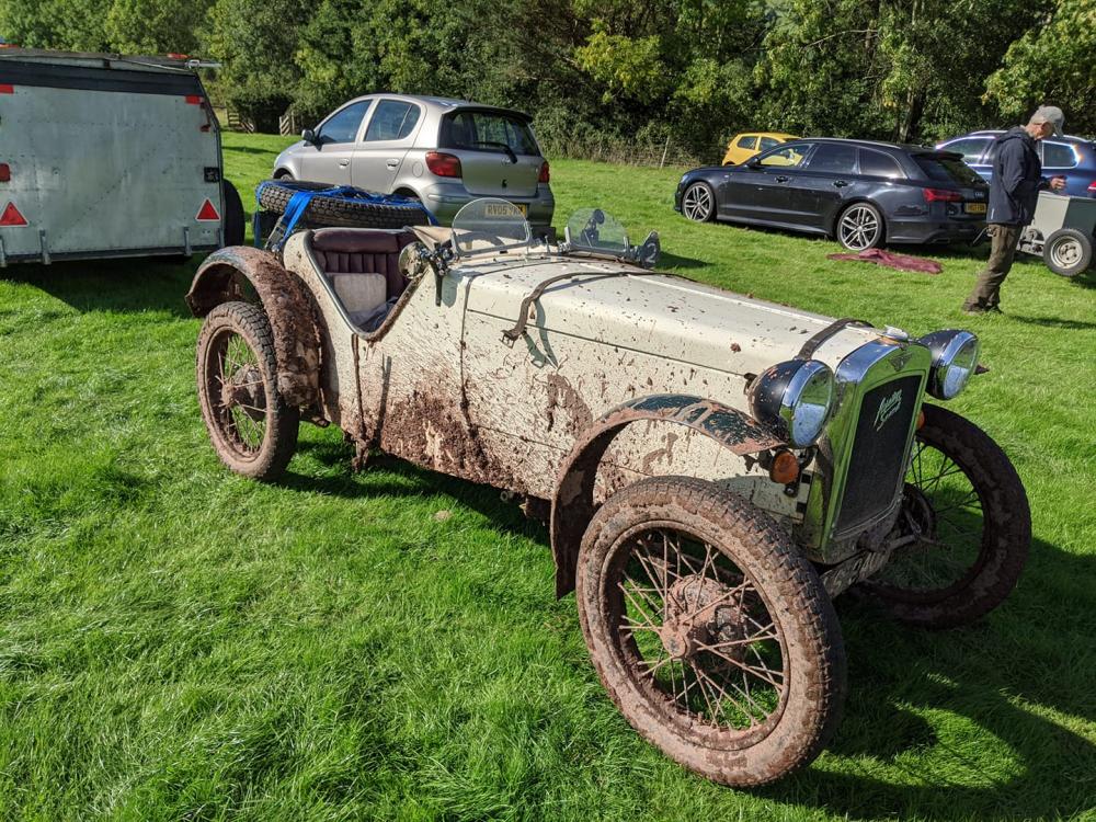

A couple of weeks ago now, I did a trial in the Ulsteroid, a rare event this year! The Minehead Mc, Exmoor Clouds, was restricted to a single venue this year, a very hilly piece of woodland just out of the town. It had some of the roughest forest roads I've ever seen! Even the drivers of class 8 modern specials were saying how rough it was. I did half the hills before deciding to pack up before I broke something significant. It was great to get out competing again, but I wouldn't recommend this event for pre war cars.

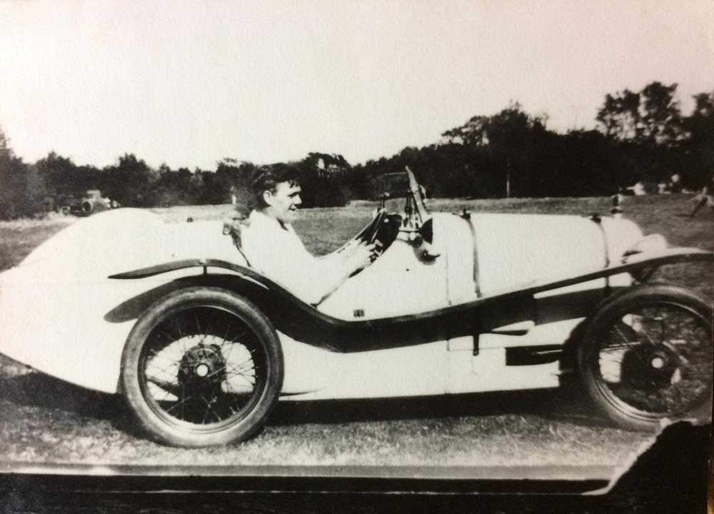

Lying under the fore end of an Austin, wondering whether to call down further curses and imprecations upon the head of the previous user of metric fastenings, and frequently the ignorer of washers, or to pray for their salvation in due course, when a visitor summoned me out and demanded tea and biscuits. After suitable hand cleaning, on the social distance of the patio, a tattered photo was handed over. Obviously a copy of something much older, evident tear on lower rh corner of original. On the back a pencil inscription. "J. or possibly S. K. Dolland or possibly Bolland? Brooklands Austin. Touring Trim. 1928" No mention in Boddy or Canning Brown, any ideas?

The wheel rims suggest this is a late-1925 or early-1926 car; the number of accessories fitted means it's probably not seen much serious competition use.
