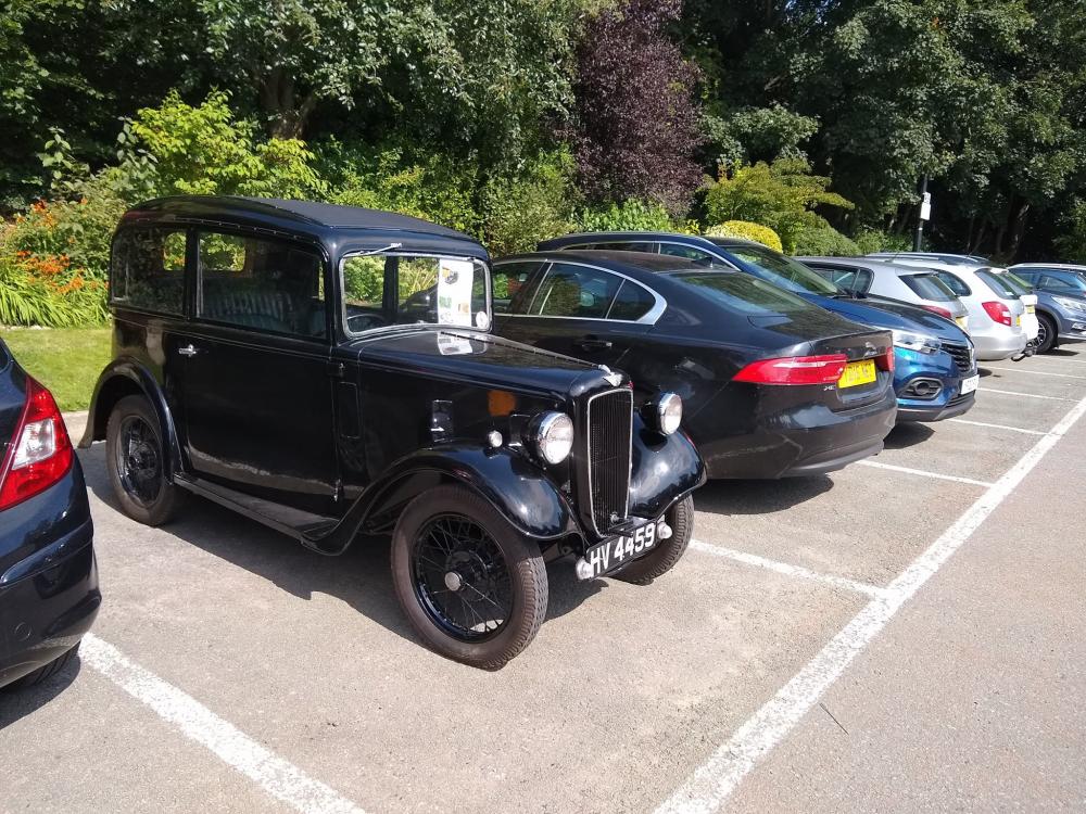

Next job was to get all the wiring finished on the 1934 tourer.  Electrics have never been my strongest area but things were going well when this photo was taken and I soon had all lights working except for the flashers.  These worked erratically and after a lot of fiddling got to the stage where the flasher lights worked but the tell-tale buzzer was a continuous sound.  I think the problems are caused by having LEDs at the rear and conventional bulbs at the front, and I probably need a different kind of flasher unit.  Any ideas gratefully received.
Not a good idea to mix led and conventional bulbs  on the indicators. The filament in an incandescent bulb provides a leakage to earth that will needs diodes to allow the leds on the same circuit. The leds also require a low current flasher unit so you really can't mix them. Get an led flaher unit and fit led bulbs all round.

(01-08-2020, 10:24 AM)MartinH Wrote: Not a good idea to mix led and conventional bulbs  on the indicators. The filament in an incandescent bulb provides a leakage to earth that will needs diodes to allow the leds on the same circuit. The leds also require a low current flasher unit so you really can't mix them. Get an led flaher unit and fit led bulbs all round.
That's the conclusion I had come to.  Thanks for confirmation.
If you have an indicator warning bulb on the switch or dash that needs to be changed or protected too!  I took ages to realise this was causing my left indicators to echo the right and vice versa.
