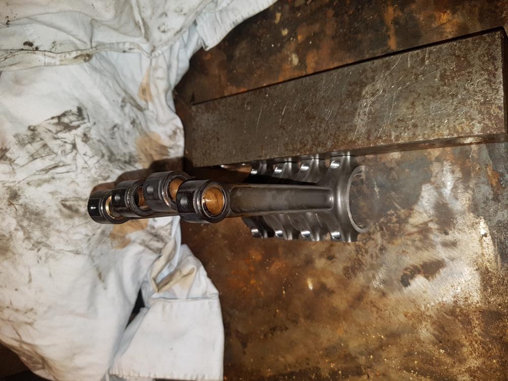

Upon further investigation it wasn't just the block.
Crank and cam appear straight but the Phoenix rods have taken a beating.
The question is whether it's safe to straighten them or do I have an expensive set of paperweights?
If they are paperweights then I'll be looking for replacement rods ideally from a Renault (or from Phoenix)
Charles
Ps - apologies for the sideways picture. It wasn't me, honest!

#45
Hi Charles, What do the Pistons look like.
Also what was the reason for having to fit a new Head gasket.
Use the Rods as paper weights not worth the risk.

I presume the paper weight reference is tongue in cheek. Unless nitrided and therefore now cracked, certainly would not consign to scrap if the opening is still circular. Maybe these are heat treated different but conrods in many makes stand incredible bending  when things go bang, so unlikely to be seriously affected by slight distortion. (i have seen folded double) The rods are massive for such small pistons and for the revs intended for original sports cars.  Straightened would seem likely far more reliable as a road rod  than typical used Austin originals.
