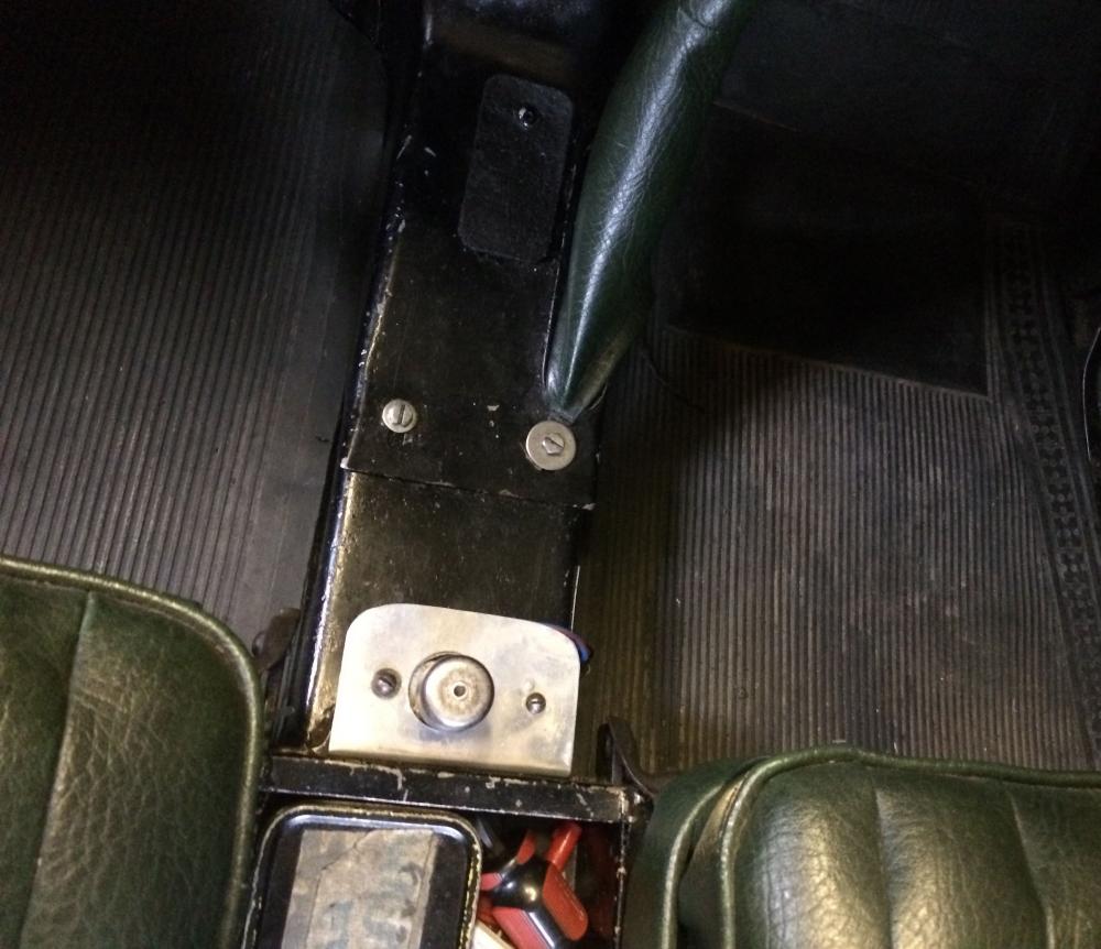

I have a funny feeling that my Fathers 1933 Box Saloon had a floor mounted dip switch.
Twas a long time ago when I last drove it ( 1981 )
