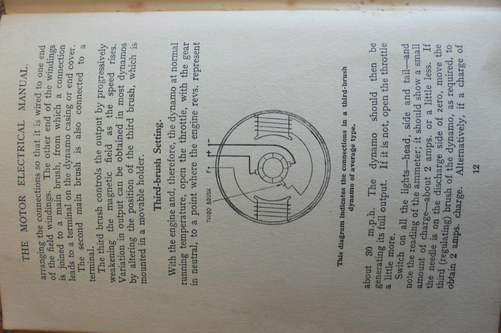

I am not sure whether this will assist you, Jamie, but I attach a copy of two pages from the 1939 edition of The Motor Electrical Manual showing the internal wiring for a three brush dynamo.
Sorry that they are on their side. If I try to orientate them correctly, they become too small to read the print!

Thank you for all of the replies and the scanned pages from the The Motor Electrical Manual. Having had a couple of cups of tea, looked at the scans which David posted and cast my mind back to when I dismantled the dynamo last summer, I realised that the only reason that the wire fell out was because I had unscrewed it from the brush holder........ How to feel like a twit.
