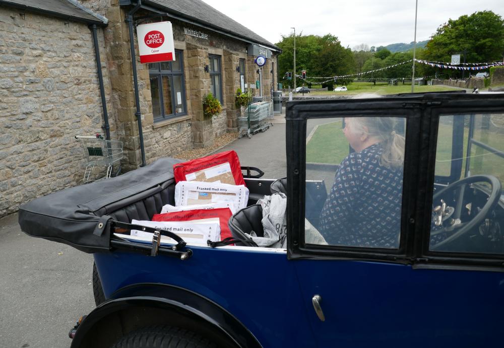

After a busy, 3-day weekend - plus Monday - the mountain of post was delivered by Chummy. A super run out, around the Dales.
