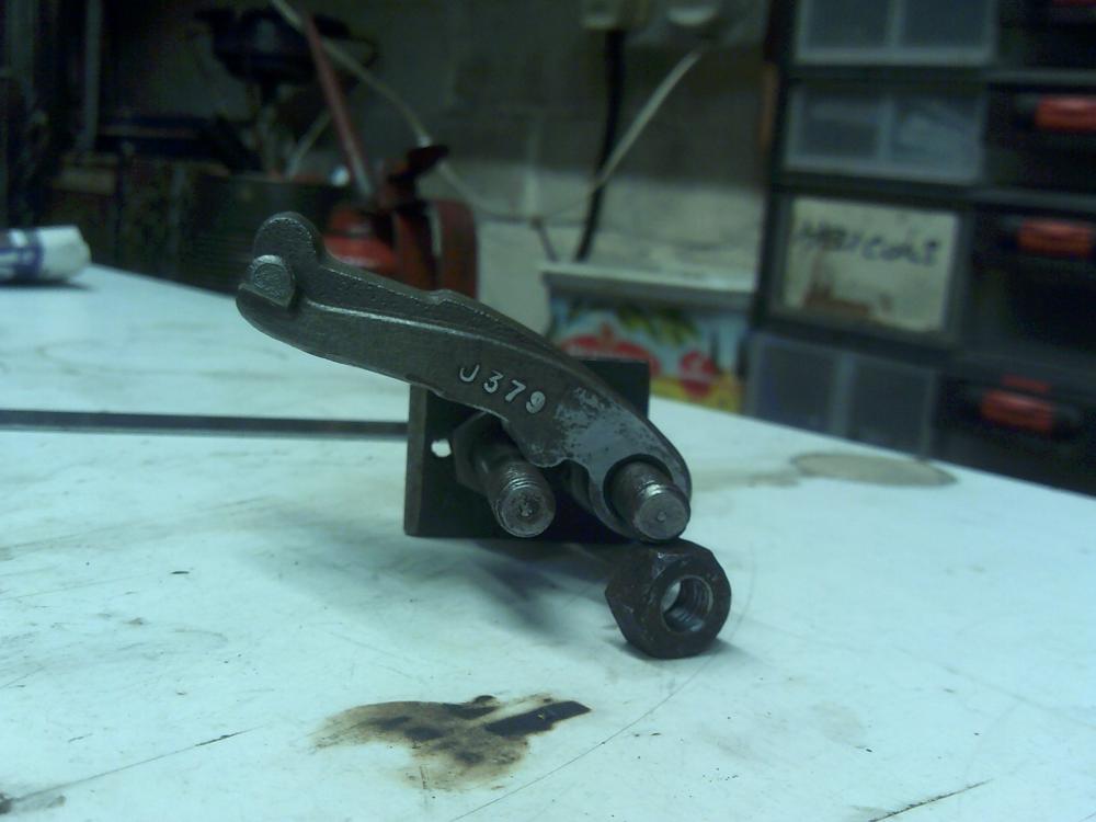

    This photo shows the difference in profile of a new old stock 3 speed toggle lever and a 4 speed toggle lever, the last time I checked new toggle levers they were the same profile.

(12-05-2020, 09:24 PM)Dave Mann Wrote: This photo shows the difference in profile of a new old stock 3 speed toggle lever and a 4 speed toggle lever, the last time I checked new toggle levers they were the same profile.
Dave - and with that finding, which one of your two NOS levers did they match... or were they some way in between?! (I was just noticing your finding in the photo today... and wondering what and where the difference mattered in relation to mixing parts!)
#28
The nearest one (J379) is a 4 speed toggle lever which is the shape of all new toggle levers. The one behind is an original 3 speed toggle lever. The difference puts the 3 speed clutch pedal nearer the floor.
