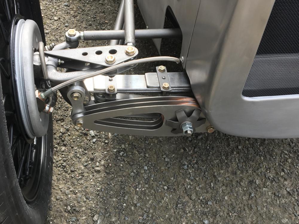

My take on JM's design.

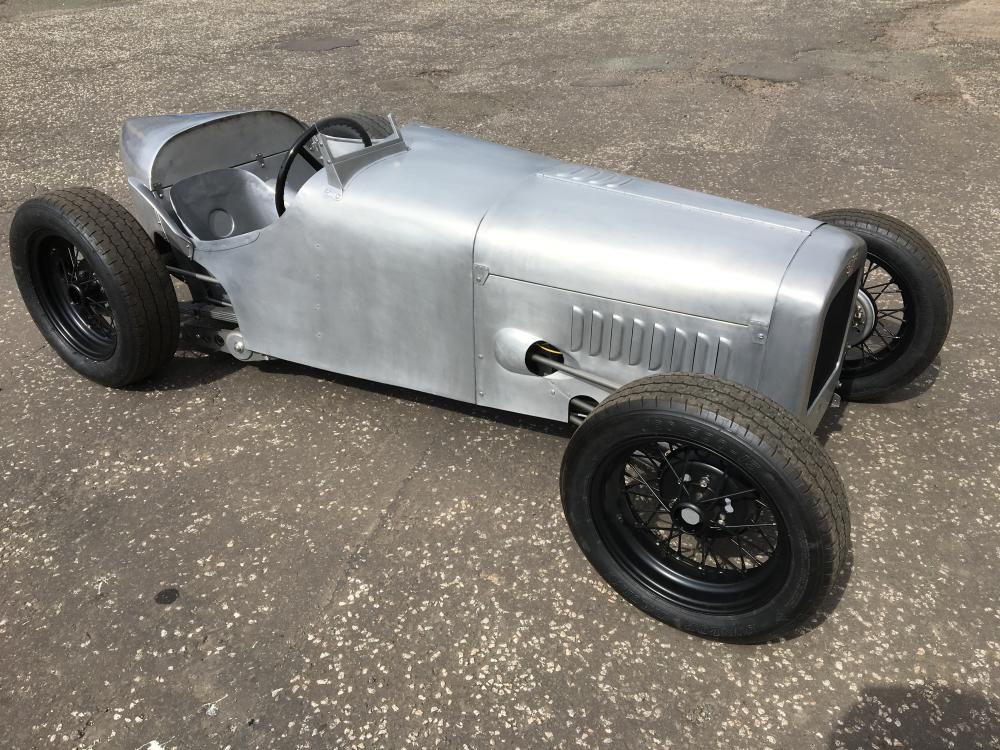

That looks like some beautiful engineering. Could we see some more photos of the rest of the car?

Sometimes see "belt and braces" safety brackets on similar lines. However if the arm fails at the shoulder instead of at the more usual radius may be of limited assistance.

(17-12-2017, 04:18 PM)Bob Culver Wrote: Sometimes see "belt and braces" safety brackets on similar lines. However if the arm fails at the shoulder instead of at the more usual radius may be of limited assistance.
True, but its a stronger Big 7 arm which has also been been crack tested and polished. The fabrication adds some strength but its main purpose it to facilitate canging the steering ratio.
(17-12-2017, 04:12 PM)Nick Salmon Wrote: That looks like some beautiful engineering. Could we see some more photos of the rest of the car?
Thanks Nick,
A couple of photos for you.

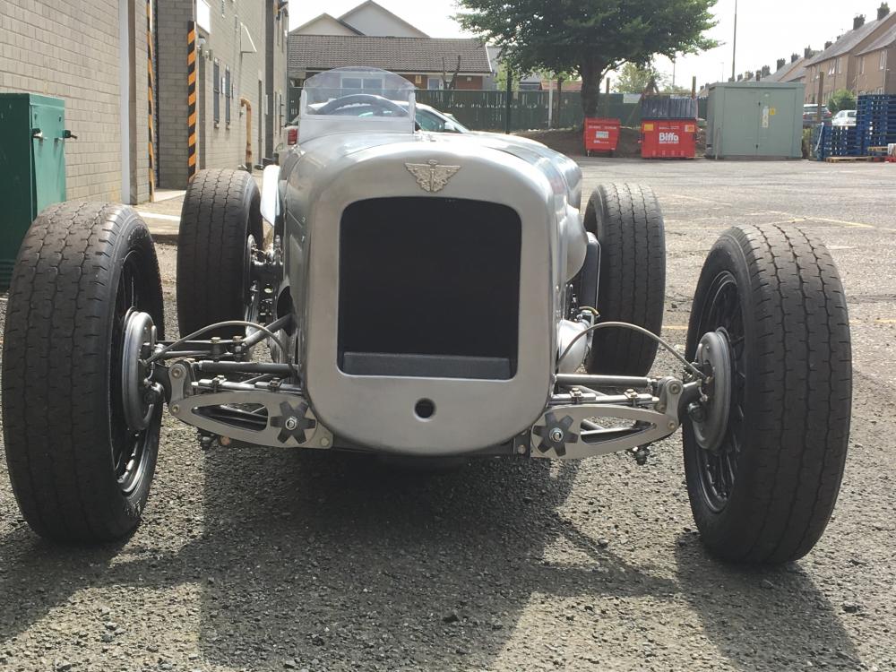

That is a delight to behold!
PS, I can see only one pic, are there more?(please?)

(17-12-2017, 06:09 PM)Duncan Grimmond Wrote: That is a delight to behold!
My pic seem to be too many mb's. I'll try and post some more if I can work out how to modify them!
Another go.
Another go.
