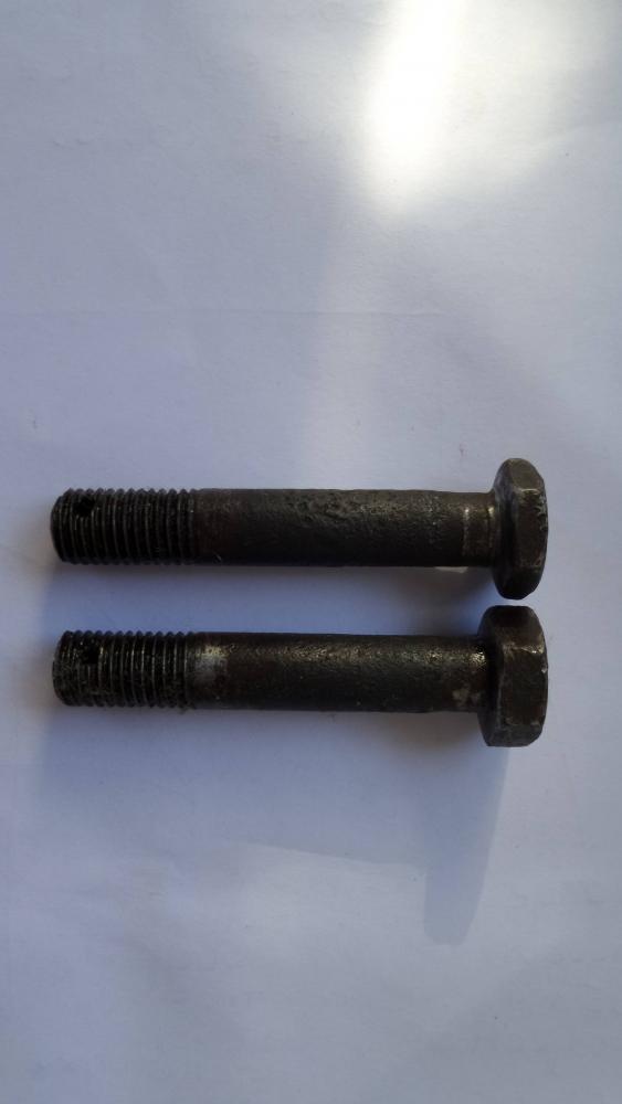

When trialling we used to use the top and bottom rubbers of the later rubber mounts with long bolts and locknuts at the rear and longer bolts bottomed out at the front.

What means "bottomed out" please? Not sure I understand that! (Silly frog!)
Joined: Jan 2019 Posts: 1,576 Threads: 21
14
Location: Bala North Wales
Renaud,
A bolt has a threaded portion at the bottom, followed by a plain shank up to the head., unlike a setpin, which is threaded all the way up its length.
A bolt " bottoms out" when one puts a nut on the reaches the end of the threaded portion without putting any tension on whatever the bolt passes through.
Hope this helps (and no, you are not a 'silly frog' - English is the most awkward of languages with lots of obscure idioms!)
