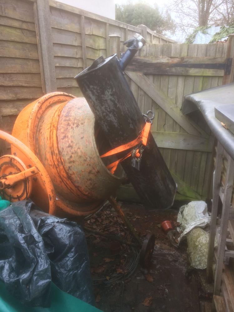

    phase one  cleaning of a tank that has been stood for 25 years

Hope you'll show us what came out. And what did you put inside to ground the walls?
Renaud
I used a handful of brass bits and bobs, mostly 1/4" rod, cut up when I did this with the Chummy tank a few years ago......

The first flush was just water and washing up liquid with a good handful  of 3/4” gravel . After running it around for about an hour it came out like thick black tea and sand. I took a video of it pouring out but can’t upload it.
