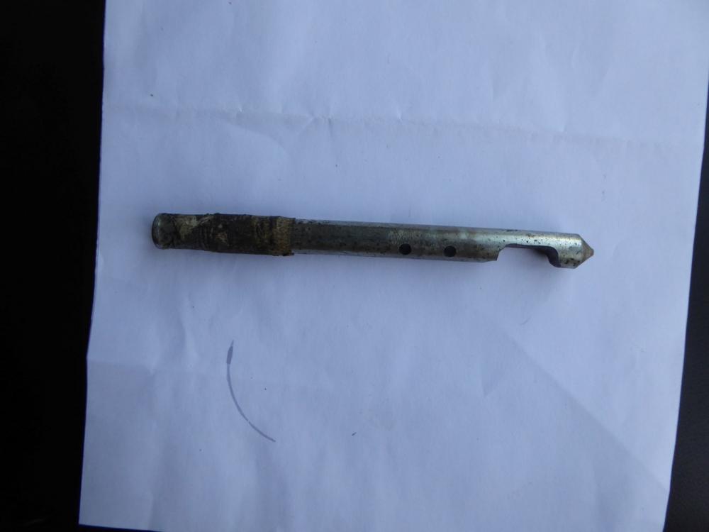

Thanks all. Yep, that's what my punch looks like now! - thankyou for that pic. I''ve been gradually taking sections out with the grinder.

Try again:
(The holes are because it is recycled from something else, the tape at the top sticks it into an old button press wot I have.)

Washers are used if the rivets are too long to make off properly.
There is a special tool for punching the rivets over. Its a punch which is bent to clear the side of the shoes.
It is non Austin Seven specific and is used on some old motorbike brake linings as well. ( There is also an Austin Service tool for this as well )
Unfortunately not an easy thing to find.
The local brake specialist used to have one along with the special cutters for the rivet holes in the linings.
Unfortunately they are no longer in buisiness.
Well, I found the most successful riveting was done with a little nut on the side of the rivet top to stand off from the brake material, and just pressing in the corner of a big metal vice, which is easy to do with the 'curly' web on the shoe. The tool never seems to be quite at 90 degrees and the ones I started needed finishing off in the vice for tightness. And perhaps I'm not hitting the thing hard enough.
