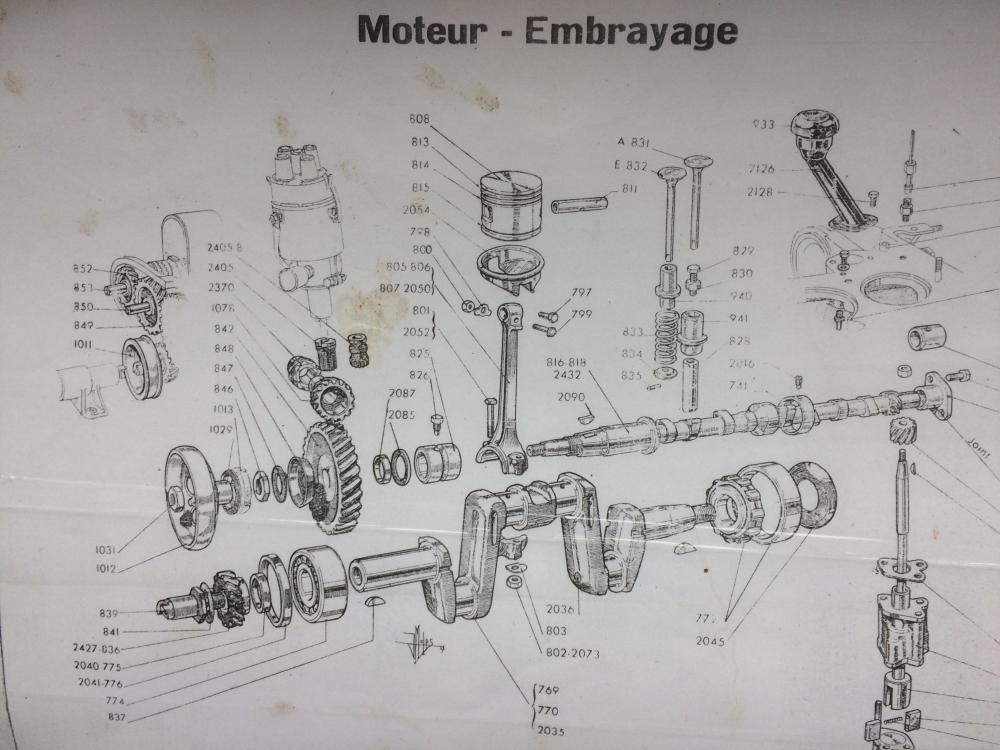

Those diagrams will undoubtly help when I will be rebuilding the engine Derek. Excellent. If you could email them I would be grateful of course.
