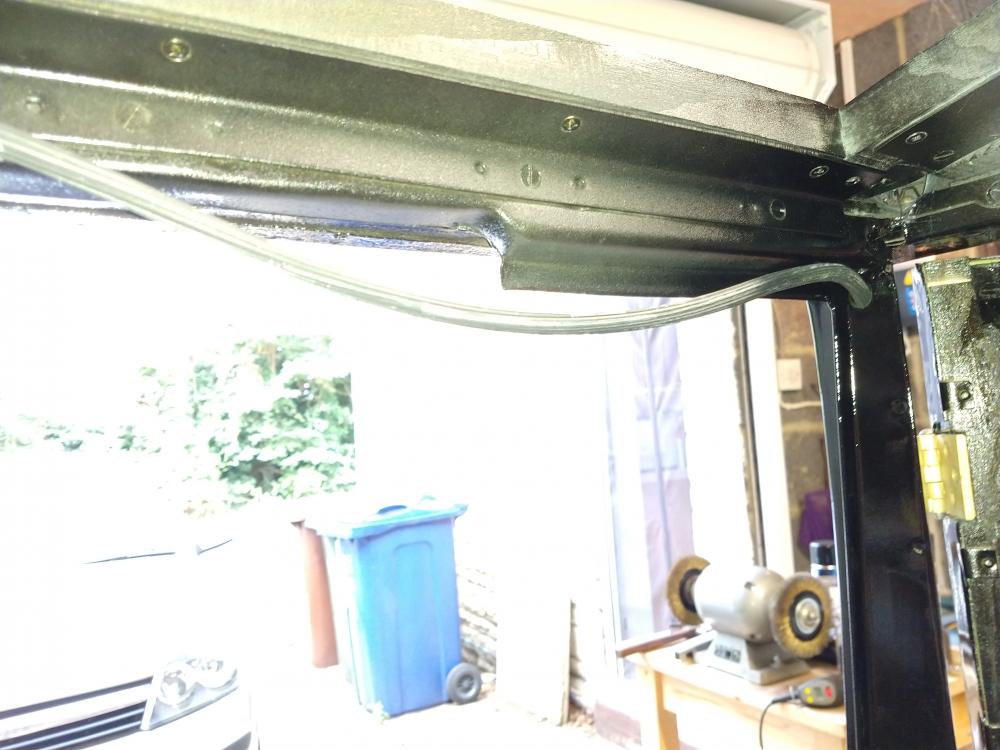

2) Attaching the vacuum wiper motor to the windscreen is not a problem but where is the vacuum hose / pipe (what is the correct Englis term for it?) put? Where does it leave the body to reach the inlet manifold and where is it attached to? Are there any photos, technical drawings available?

Regarding the vacuum hose, it is a special pipe with 'ribs' on the outside, and it travels down the inside of the door pillar and on my RN it comes out just below the glove pocket.

Do you have any pictures of where the hose leaves the body and where it is attached to your inlet manifold?

I need some of the same answers. I can tell you that the vacuum tube runs along the top of the screen and into the door pillar, then pops out under the dash, but what happens then I also need to know as mine was broken off under the dash when I got the car. Presumably it goes through one of the many holes in the bulkhead.

On my RK the pipe runs down the windscreen pillar right across the scuttle and out of a hole close to the choke pull. There is a push on tube screwed into the inlet manifold.

The vacuum branch on the RP manifold is on the top of the inlet manifold, engine side of the carburettor flange. It has probably been blocked off. Look for a flat section and you may see the temnants where the tube was fixed. Easy job to drill it out and replace
