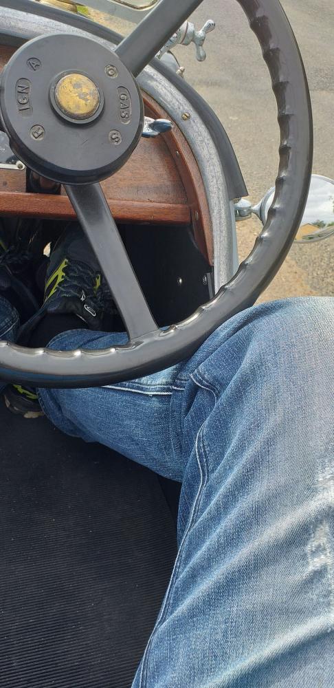

Only one problem if the steering wheel was in the suggested position with knees behind I would only need legs 12 inches long!
At present when seated with arms bent steering wheel rubs on knee, when pressing accelerator my knee is seat side of the wheel.
The idea of moving the seat back was to allow my right leg to be flatter in angle and avoid the steering wheel.
I agree that incling the seat back rest would be a benifical, cant believe I actually traveled 165 miles in a day recently.

Your knee should be nowhere near your steering wheel, if it is your seat is way too far back, your knees should form quite an angle, don't be blinded by the legs flat position of a modern sports car, those ergonomics won't work properly in a vintage car.

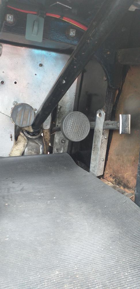

I have a friend who has a MG T D and understand the principle of the wheel being on your lap but I can not do that as there's not enough room between steering wheel/ dash for my legs to fit. At present my knee sits against side body and wheel, this allows me to operate pedals correctly as accelerator is approx 2inchs high than brake and brake is 2 inches higher than clutch, is this normal or possible the route of the problem as everything revolves around pedal operation.
I will post a picture of me sitting in the car, any comments would be welcome.

Unless you have really long legs, I think if you measure the distance between the brake pedal and the sear back you should be aiming for 34-37" approx. This will allow a straight (ish) leg to floor the brake and clutch pedals.
If you can't get somewhere near this your seat back may be too heavily padded. Anything more than 3/4" thick is probably superfluous. The lower back doesn't really need to come into contact with the upholstery unless you need a lumbar support cushion, sometimes I do as a result of an old back injury.
The taller you are, the more difficulty you may have getting your thighs clear of the underside of the steering wheel. Doors should make a difference in shoe-horning yourself in, I have to pry myself out or slide sideways to get out of the passenger side.
Try out as many different cars as possible, take a tape measure.
