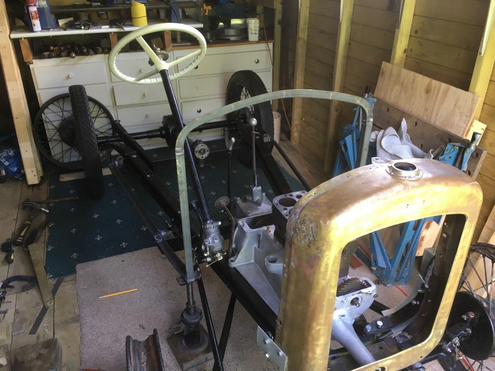

Welded the bulkhead hoop to the scuttle frame of my special.  It is 1" angle iron and was quite difficult to bend without incurring lots of twist and a painful burn't hand (cherry red steel doesn't cool quite as quickly as I had thought!). The uprights are welded onto side rails which are, in turn, bolted to the chassis cross rails.
 I plan a 3mm bendy ply - 12mm ply - 3mm bendy ply sandwich with lots of large diameter holes drilled into the 12mm ply. All topped off with a fabric finish. Hence the angle iron. The ply sandwich will fit nicely into the angle and can be attached by screws through the back of the steel.
Welcome any comments.
Should I start a new thread on the build rather than this one?

Thanks Bill and Simon
Yes I understand the over-engineering bit. My first special had an ash frame with an aluminium skin, aluminium wings and topped the scales at about 450kg even as a long wheelbase. But I fancy doing something different with this.
I'm aiming for a car suitable for vintage trials but one that I can also use on the road and will have a period look.  The "shape" will be similar to the infamous Cox tourer as shown in the current source book (I believe the car will be left out of the forthcoming reprint). So its a boat tail Bill.
The idea behind the ply sandwich came from Gordon England construction.  Rather than use ash between the ply I'm using very sparse ply.  The body will sit on the subframe and I'm hoping it will not need any bulkheads apart from the one already in place and one that will support the rear of the front mounted tank and dashboard.  Although I will be putting doors in the car and they may require some support.
Again taking a cue from Gordon England I'm hoping that the body will be totally separate from the running gear including the dash.  I can then complete the mechanics of the car without fear of damage to the fabric body.
Taking on board your comments Simon I may cut back on the ply thickness.
I think I'll hang fire on a separate thread just at thee minute and see how things go.
