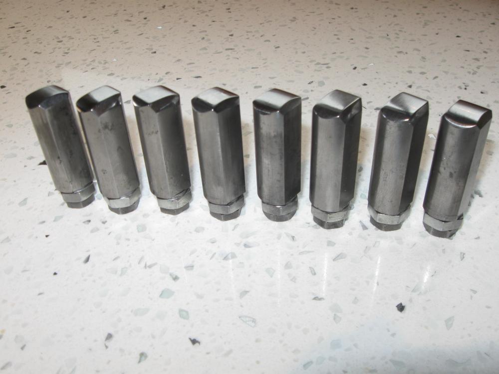

Reprofiled followers with a radius of 1.5" for a race engine, a 3/4" radius on a std engine gives a useful increase in performance without sacrificing to much torque. Check internal depth of followers before grinding as some are drilled deeper not leaving much metal before the face, I have a photo of an example will find and post.

Found photo of failed follower and one of a set I removed from an engine as they were too flat and to thin at the face.  Terry

Hi Guys
Excellent info & pictures, thanks all !!
We're in the process of sourcing a new cam with a grind for a supercharged motor and it makes good sense to do the followers at the same time
