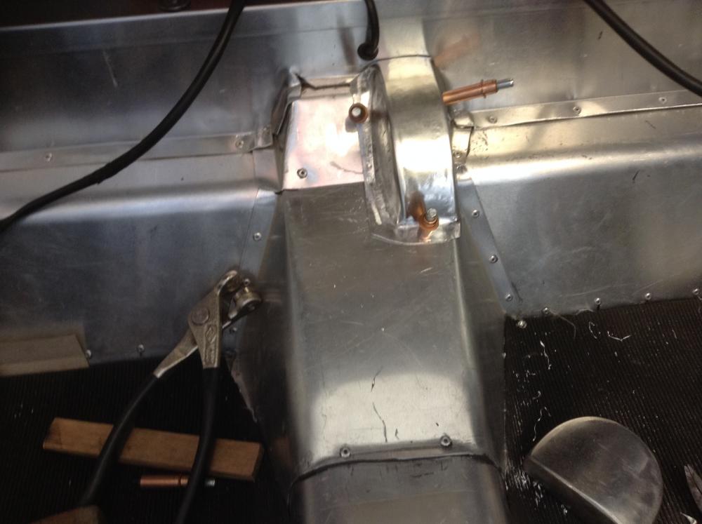

I dove out of the yard today, up to the roundabout and back. As I went over a pothole there was a clunk of the diff hitting the underside, argh!
I made the same tunnel as I did on the last special forgetting that this one has a Morris rear axle. There is a flange all round the casing which stands more proud than the Austin diff and it was just catching. Cut hole, form cover and fit with clecoes and try again. Another case of operator malfunction...

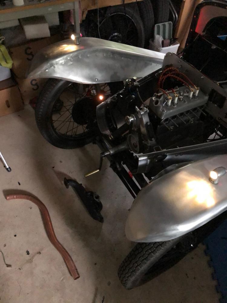

Ps finished forming the shapely exhaust downpipe
fitting it to match the manifold and the silencer took
Longer than bending it.
It has to dodge the “hoop” so ended up with 3 -4 bends
formed with a very large hydraulic bender.
Now to get the steel flange brazed to the copper pipe.

Still working on the wiring circuits and also the exhaust pipe, but
made steady if somewhat slow progress.
Decided to fit small bullet shaped motorcycle indicator housings on
the front wing supports. They are very compact housings so had to take a Dremel
To the orange LED bulbs I’d bought. After some modifications the LED fitments
Are now installed and working, using an electronic flasher unit controlled from a
period trafficator switch mounted on the dashboard.
Also fettled the downpipe and it’s now ready for having the mating flange brazed on.
Here’s  hoping the Rad shell is delivered on Sunday as promised!!
I’m taking the TR3A to the BVAC Thirlestane Castle Rally so the shell will need
To fit inside the rather tight cabin as I’ve still got the steel hardtop fitted.
