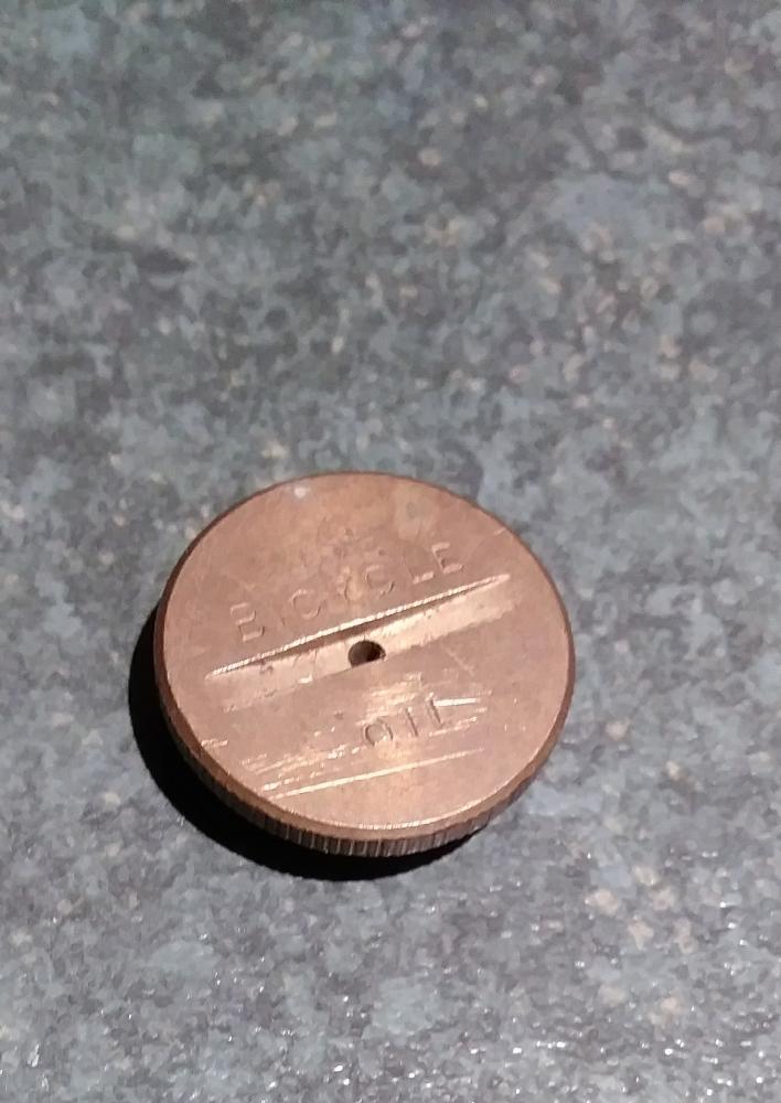

after a successful Drive It Day outing yesterday I was checking the old girl over and I've lost the damper cap from my OM type carb.
Looking on Burlen's site it's not clear whether I should have a vented or un-vented cap, and I can't remember which type was fitted to mine. I can't remember seeing a vent hole in the cap, but not sure. Is anyone on the forum running a pre-war type 1" OM? If so, would you be kind enough to see if yours has the little vent hole, or not, in the brass damper cap and post a reply.
Also, anyone got any cunning ideas for stopping these things vibrating loose other than loctite?
Best wishes and thanks for any advice.
Robin

Get an unvented one. If it doesn’t run properly you could always drill a hole in it.

Without hunting out my hoard, surely whether a dashpot or not, now or originally, must be a vent of some sort. Unless of the 1960s type with diagonal vent to air cleaner formed into the round body.

I like Alan's idea regarding the vent hole. Why didn't I think of that!
To answer Robert's question. The OM has no damper/ dashpot. The cap on these carbs is just a cap.
