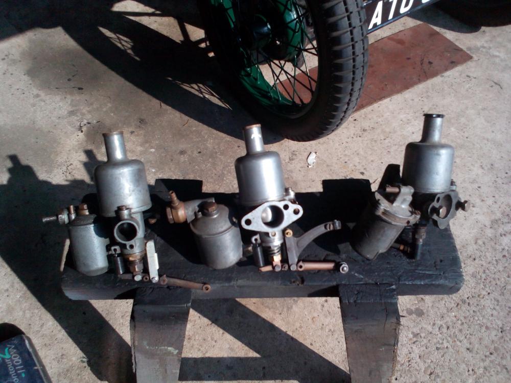

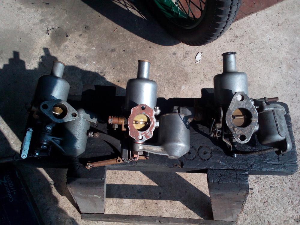

Agree with what Mark says.
From the left:
1" Side Draught OM, 1 1/8" Semi Downdraught H1 (with T2 float Chamber rather than T1), 1 1/4" Semi Downdraught HS2.
