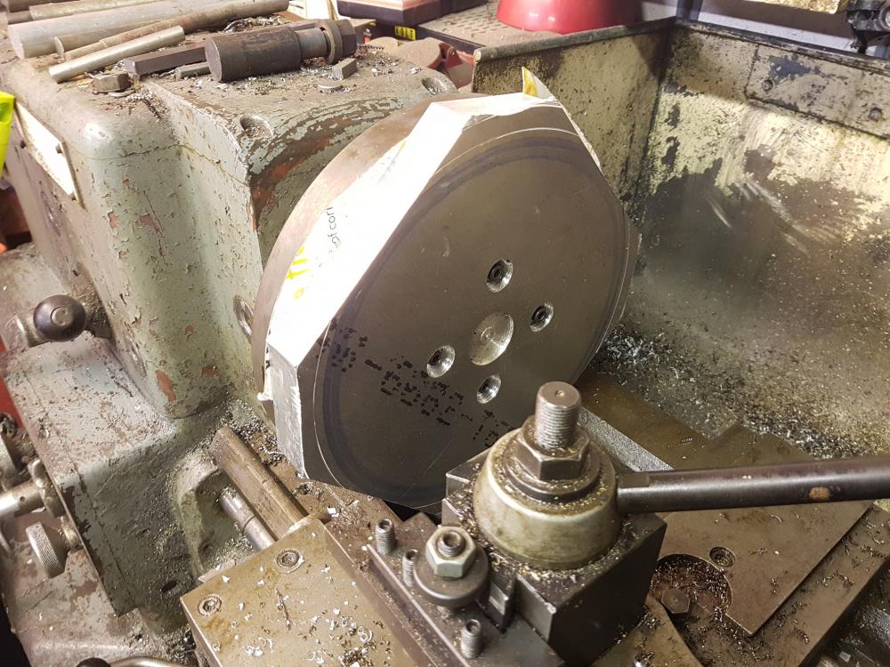

Next was to drill and counterbore it and bolt it to the faceplate. The eagle eyed amongst you may notice a layer of cornflake packet cardboard on the faceplate, allowing me to machine fully without grazing the faceplate. You may also notice that I had to shave off the corners to get it to turn over the lathe saddle
There was a lot of swarf created in this process. Bins full. Once again people may wonder about the boss in the middle - all will become clear....

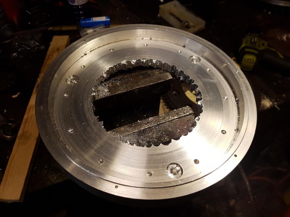

When I was sure that all the details were spot milled into place and that the holes for the clutch toggle pillars were in the correct positions I then turned down the boss in the middle and used the age old "chain drilling" process to remove the centre

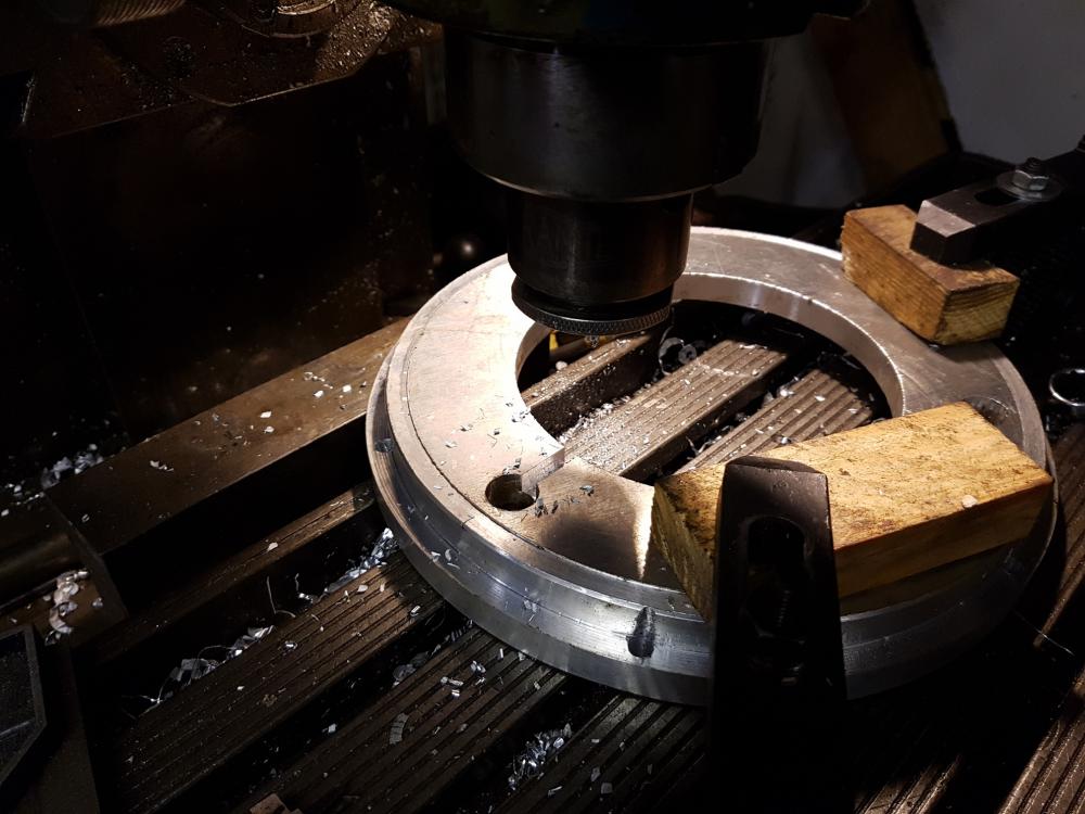

 Next stage was to pick up on all the spotted points for spring positions and mill them to the correct depth.

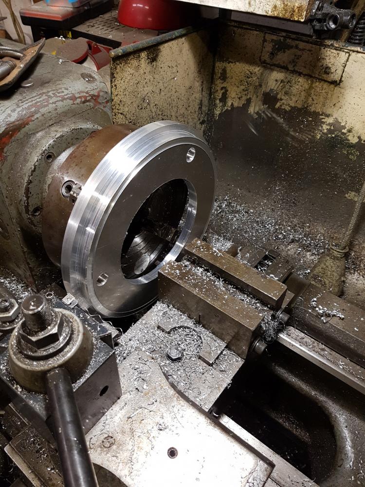

After this back to the lathe and the OD for the starter ring gear was turned

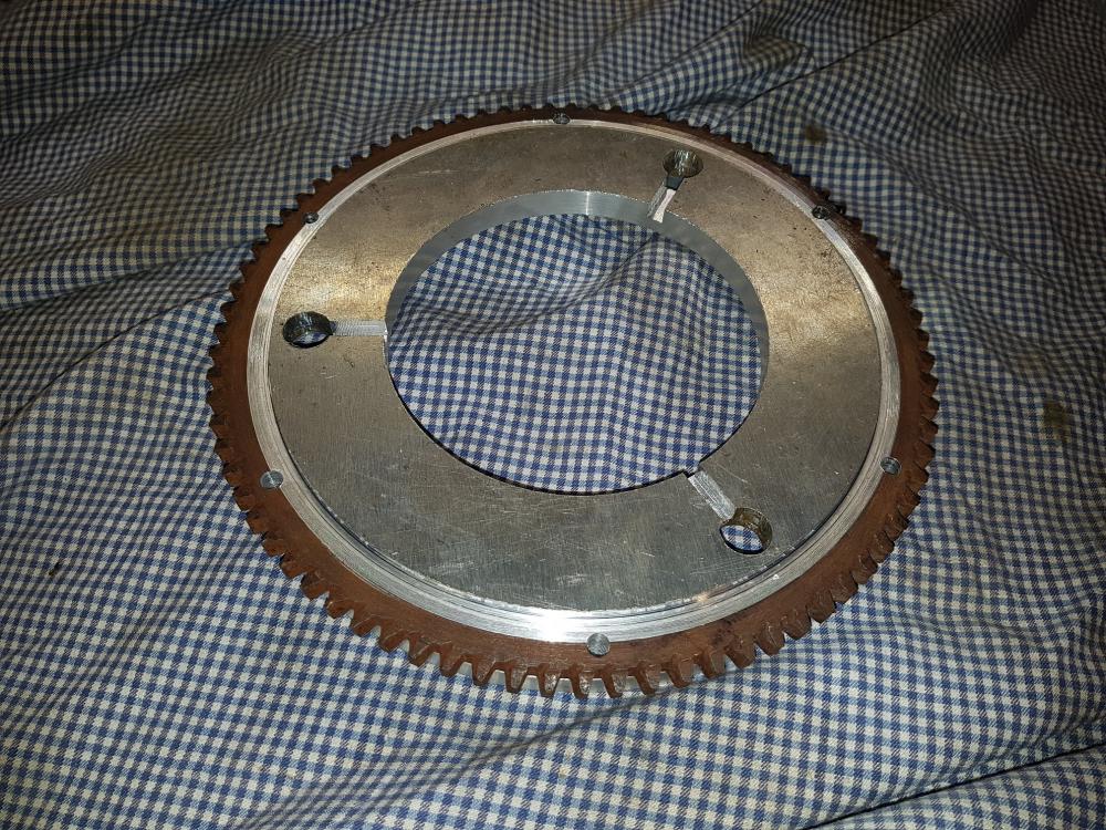

I then set off to machine the slots for the clutch levers. The pivot points holding 3/16 pins will be machined in final setting up on the real engine
Then I shunk on the ring gear - piece of cake with a domestic oven - provided that you can machine and measure to about +/- 2 thou
And voila - just about finished
Not a job for the faint hearted. Next stop cast iron clutch linings from brake discs. Anybody know where to get clutch rivets?
