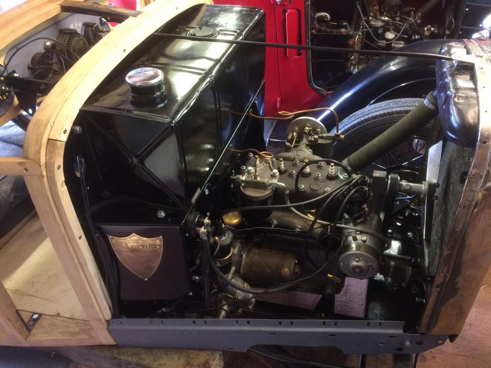

This is a shot of the filter fitted to my Rosengart van . As you can see the oil pressure gauge is taken off of the top of the filter. I am pretty certain that I got the unit from Paul Bonewell. As stated earlier you have to block off the oil chamber . I used the same size tap as the thread in the chamber plug and ran it on in. For the plug itself I turned off the hex on the plug that I removed on other end of the chamber. The original oil pressure outlet will also need enlarging.
I hadn't realised until I previewed this post that you can also see the same mod on my Opal in the background of the picture.
