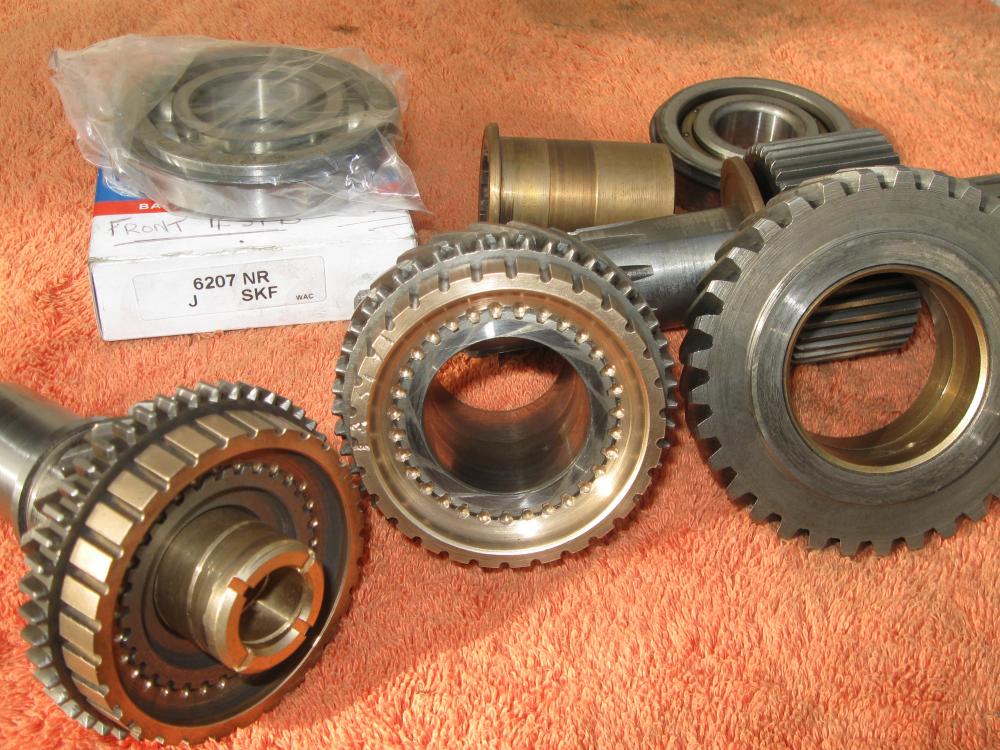

I am busy rebuilding my gearbox (with close ratio gears) and have replaced the inter shaft roller bearing which is fairly worn with the plain bush. It slide over the shaft when I tested it out of the shaft and it pressed into the first motion gear fine.
But now I find the shaft won't slide all the way in. It seems to bind up on the last few mms. Even though I can't measure any difference in the shaft diameter you can see where the rollers have polished it a little and a bit of engineers blue wiped on the shaft showed that it is rubbing at that point.
It must be very close to fitting. What is the best way to fix this?

Hi Simon I have just reread your first post. I seem to remember the Retro-fit Bush has external oil grooves  as well as internal, which means that it rotates within the first motion (input) shaft as well as turning on the third motion shaft  (output) so it has twice the bearing surface and acts in the same way as the roller race it replaces. Is your Bush made this way ? if not I think it should if it is to last.
Have you a photo to share?

I've always been told bushes that are a push fit will close up slightly once pushed in place. This one I definitely had to push into the first motion shaft (using a vice and a socket as a pusher on the face) but it wasn't hard to do. When I checked it on the shaft I might not have made sure it went all the way down. I've been caught out with that before with a spigot bush on an MGB which prevented me from getting the gearbox to mount as the gearbox input shaft wouldn't fit into the bush in the crank. I ended up having to remove the bush with the toilet paper and wooden plug and BFH method!
It definitely doesn't turn as you mention Steve. Turbocharger bushes work that way and have quite a bit of play but then they run lots of oil pressure too. This is definitely a tight fit in the first motion shaft. I will try the Brasso method as it feels only just tight. I suspect the problem is the shaft and where it is worn not the bush.

Hi Simon this is not a problem you find this with most of these bushes, check for any machining burrs polish out the bore of the 1st motion
              shaft and the outer side of the bush the fit is not critical it just has to freely slide on both surfaces. If you as fitting a set of c/ratio
              gears you usually find the bore of the 1st motion shaft has shrunk and needs polishing out with a small emery drum.Parting the
              layshaft depends on the fit some you can knock apart with a shouldered brass punch or you may need to press it apart.
Terry.
Thanks Terry, the bush I have looks exactly like that. I'll figure out some kind of press to get the layshaft apart. Knocking it with a drift got it a mm or so. I just wanted to make sure there was no trick like with the king pins!
