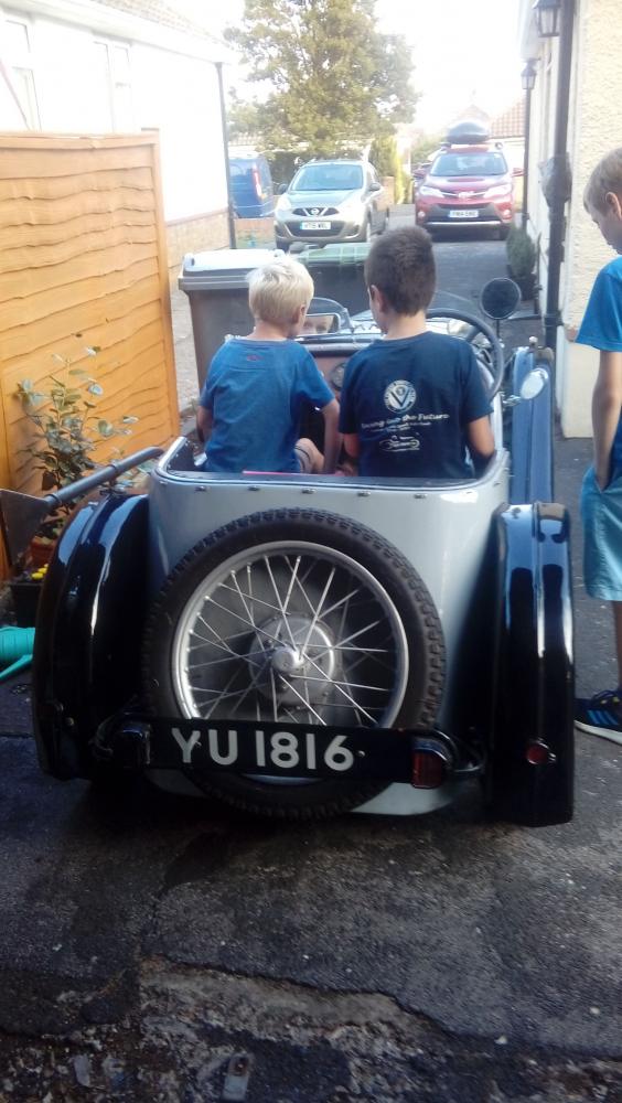

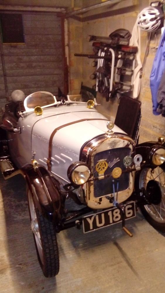

As a newcomer to the Austin Seven forum I would like some advise on how to modify my recent purchase for VSCC trials.
The vehicle is a 1927 special (6v) I'm about to start rewiring but my major concern is the amount of ground clearance required to successfully compete. As you can see from the photo's the car has lovely running boards which I would prefer to retain plus a very low rear end. It looks fantastic and i'm reluctant to modify, can anybody advise if its possible to lift the body to gain extra clearance?

Is it on 19" wheels at the rear?
It probably has flattened rear springs, you could replace with standard springs which will make the rear end sit up nicely.
Raising the body is not an easy option.   Nor is changing the springs, but there will be fewer resulting problems to resolve after changing springs.

How far below the bottom of the chassis rails are the running boards?
A photo of the underneath would help.

Hi Simon
thanks for the reply, yes she does sit on 19'' wheels.
Since the photo was taken I've removed some crude homemade springs (like old pram springs) that were attacked to the rear axle and chassis, effectively pulling the body down.
I'm still worried about clearance, only time will tell.
The battery I plan to refit to the rear as it does sit under the car at present, the exhausts not a problem as it runs outside the car on the n/s.

(01-10-2018, 11:11 AM)Paul Nott Wrote: Hi Simon

If the springs you removed were coils (like bed springs) mounted on aluminium blocks on the axle they were probably "Nobby Spring Assisters" ....They were fitted to my axle and onto the rear floor (no extra support or "load spreading!)
A "period" modification! You may find an old ad on Google ....10/6d  a pair or something!
I took mine off! The mounting blocks were broken anyway!!

If it is any help:   my '34 Tourer has 7" of clearance between the top of the tyre and the underside of the middle of the muguard.
The bottom edge of the running board is about 1" below the bottom of the chassis rail, and 13.5" from the ground.   The rear chassis rail is about 2" lower than that.
I think the springs on the tourer are set too high, the back end looks a little jacked up.
Plenty of clearance for trialling, if I was that way inclined.

Now you have me thinking - if I wanted to trial that car, but not change the springs.....
Which in turn has generated two more thinks: 1)  one way to lower a car is by removing leaves - worth checking.
                                                                       2)   the back end is too low, anyway.   Something needs to be done
                                       ...................one could provide an extra set of axle spring pin eyes below the existing ones
I think I could do this without modifying the orriginal axle permanently.   And without crushing it, which exhaust clamp type clamps can do.
But I doubt the scrutineers would like it much.
Simon
