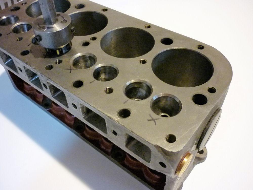

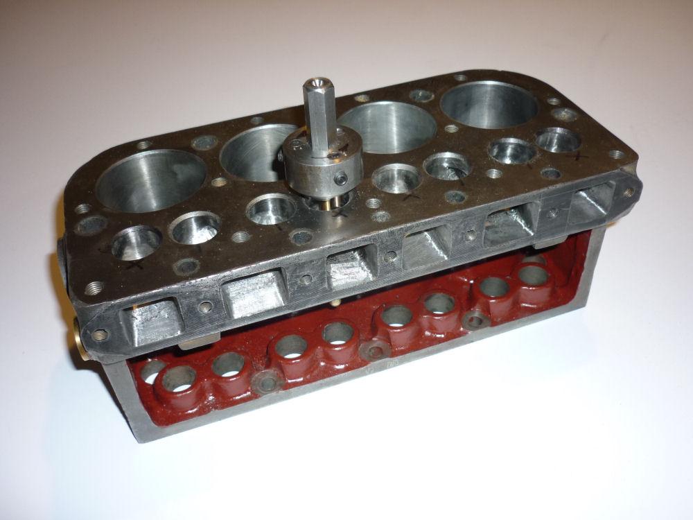

An update on the tool:
It works !!!
The tool was used with a speed crank and socket and required moderate down force to basically scrape the surface to be cut. It was not aggressive and did exactly what I wanted.
The four holes on the right have been done. Once all of the seats are cut I will select the valves according to best fit for each hole and then use grinding paste to lap them in.

Good work Stephen,
      I use a diamond plated valve for cleaning up burnt seats. With a little paraffin it cleans up the seat in no time. Five to ten minutes for four exhaust seats
Excellent work Stephen.
Well done so far, that's some lovely work on making the tooling. You have skills.
It looks like you have some juddering on the cutting surface from having so few cutting heads?
A seat cutter will have around 20 cutting heads.
Also A pickervant kit usually gives you a grinding head, it may be worth buying one of these on its own to grind back the judder.
Also Austins recomendations is the seat head should be no more then 2mm.
The pickervant set usually gives you two cutting angles, one for the seat. And one to cut the excess at another angle.
Hope this helps, Tony.

Yes you are right about the juddering and the seat width. The seat width is a little wider than i would like but at this point I don't want to have valve seat inserts put in as I'd like to keep the block the way it is if possible. Given the age of the block,  the amount of wear on the seats is negligible  so I'll wait and see how it goes considering that the car won't be working hard in its future life.

Hi Stephen,
Just make two sets of cutters to fit in your holder one 30 degrees and one 60 degrees this will allow you to cut the inside and out side of the seat to get the right width on the valve  and central on the valve face.
Hope that helps
Colin NZ
