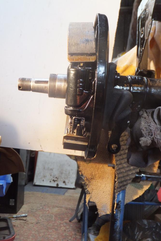

Some photos of current state
Trial assembly.  It can be seen that the larger spring on the left may just be able to go behind shoes and fit inbetween raised flange side and the pivot block. But the right double ended would not go behind shoes.
attachment=3641
This shows how much the top shoe is pulled out from the back plate even with the behive spring attached.  The bottom shoe not so bad.
close up shows that if the side of the raised mounting flange was moved towards centre (there is about 3mm space between axle mounting flange edge and side wall of the raised back plate flange) The double ended spring might be able to fit behind shoes though it would probably just touch side wall.
Close up of larger spring shows that, again, with flange side moved in towards centre by about 3mm the spring would sit between shoes and back-plate.
must give up on more pictures as it seems to take an age to get a photo attachment attached. (around 20 mins per photo!!)
Still not sure the top shoe is the right way round.
As it is all beautifully painted up and mounted I do not really want to go hacking the back-plate around only to fail to achieve the goal of both springs between shoes and backplate.
Dennis

I Have just spoken to ESM Morris Minors workshop and they confirm that both rear shoes should be fitted with the ends with 2 holes at the pivot block.  So my first photo shows them wrong.
First photo showing wrong shoe positioning now removed  I will take another with all correct way round.
Dennis

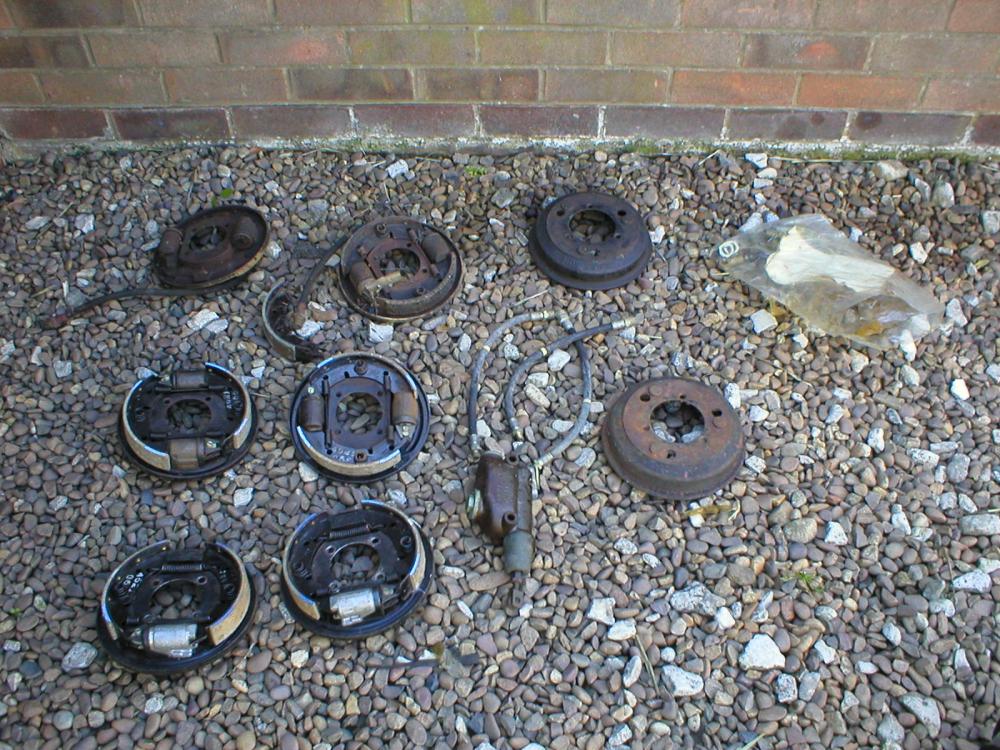

I've never used hydraulics but a few years ago, with a load of spares, I ended up with a complete set of Super Accessories hydraulics, new and unused together with some used hydraulic bits. I sold them for very good money on ebay but looking through my photos I find I have a shot of the assembled front and rear backplates as they came to me and also one of the front sheet of the original Super Accessories fitting instruction. Regretfully I don't have a shot of the rest of the instructions! See below if it's of any help.
