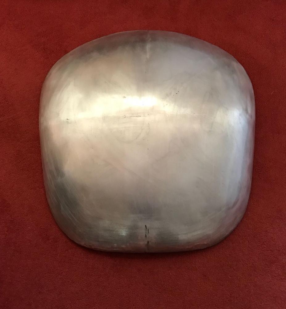

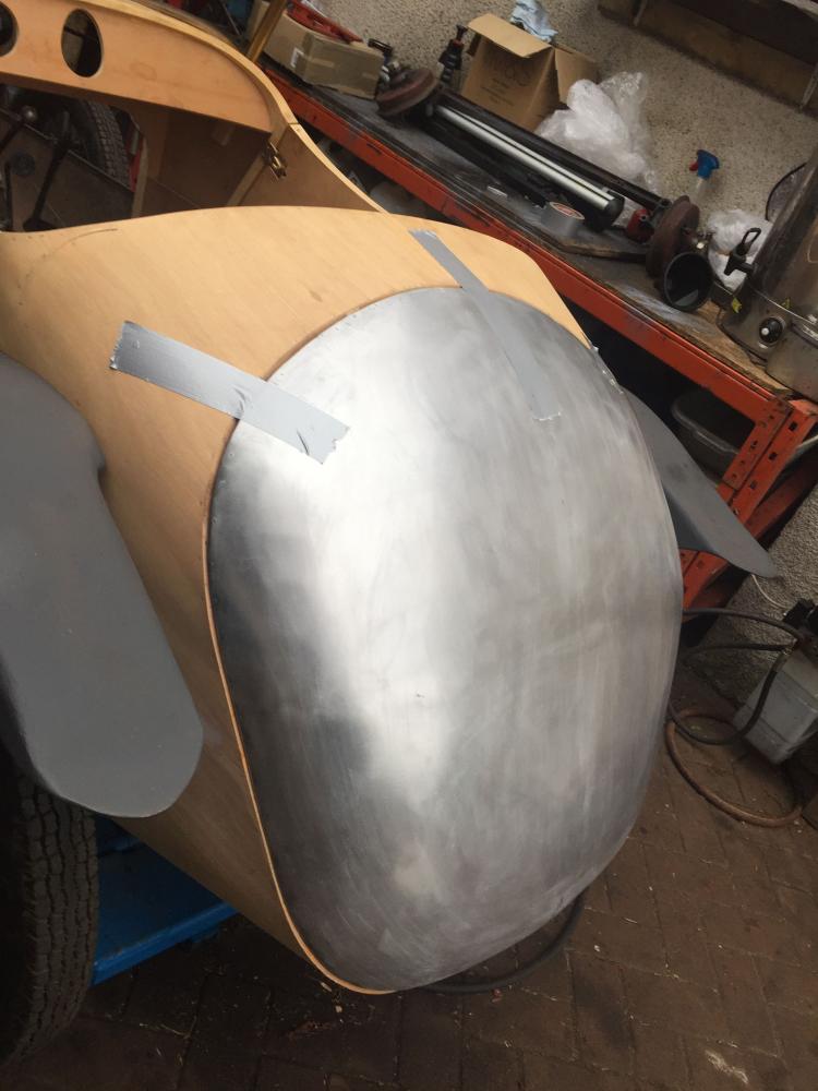

One small part, one giant leap towards completion!
With thanks to Andrew Goodfellow who made what is possibly the most complex body panel fitted to an A7 for me - delighted!
[attachment=3500]
Next step, covering.

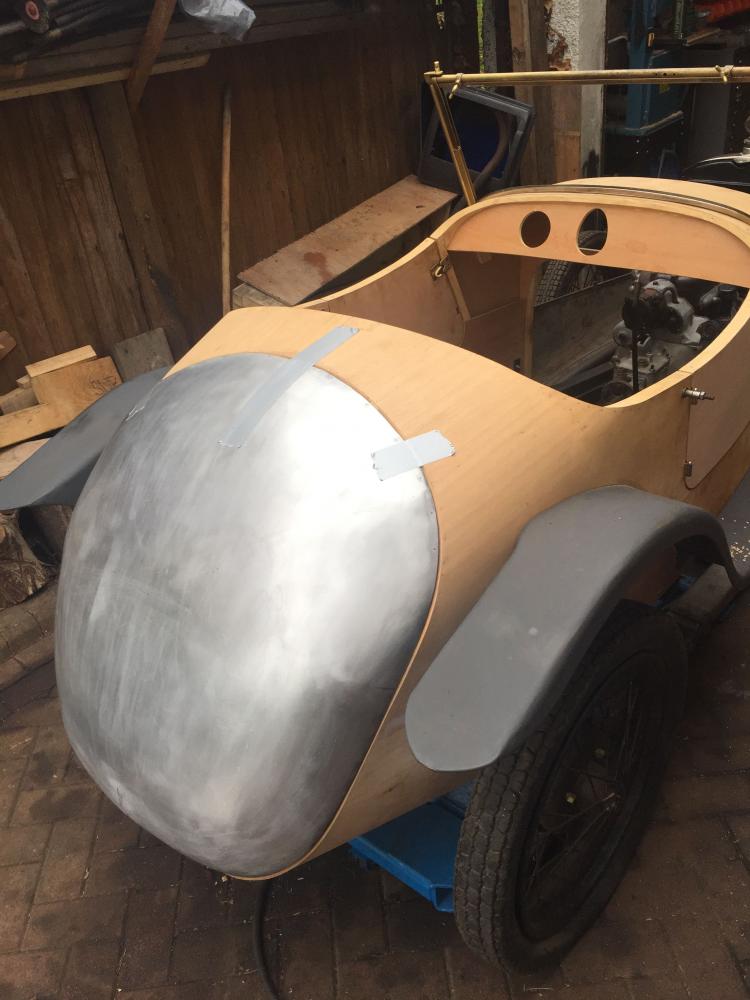

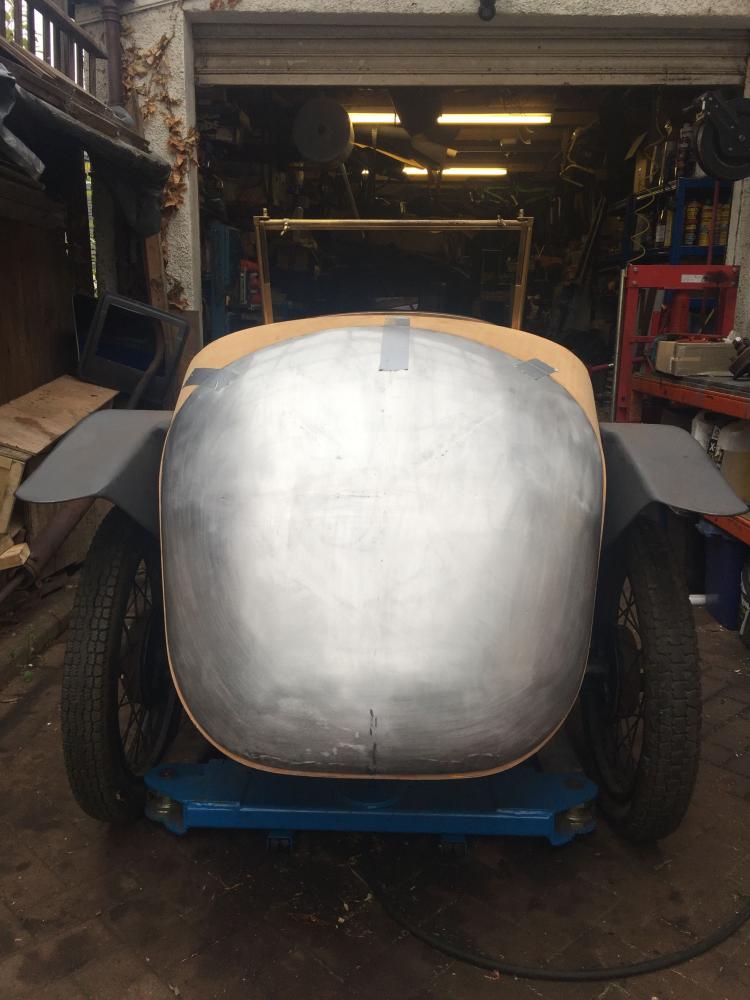

I think Andrew was expecting you to speak to him about making one for you and your friend, at Guildtown??
More of it in place...
#58
Lovely work. Have you decided what you are going to use as a covering?
The boot lid is tough to cover as there is a large radius on the top, straight side and small radius on the bottom. You need to be able to hide the fabric as you take it up out of the small radius corner.
