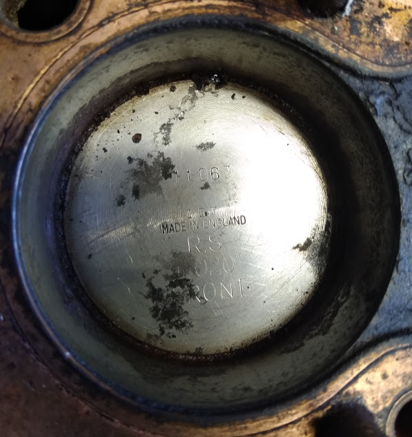

Chevrolets were about the only car to retain iron pistons post 1930.
Cycles of heat on the stuck piston may help to free. If you have nothing else can be held over a candle! Clean bore with very fine paper. The conrod and white metal are precious so do not damage. The rings are sure to be stuck after piston is pursuaded out. Standing a household iron on the crown can be used to heat and may free. If wear is moderate and piston skirts not collapsed, pistons and bores may be reusable.
The crankpins are drilled to provide communication from the oil receiving troughs in webs to the crankpins. If you have not noticed the oil jets in crankcase, take care not to damage.

The numbers you've found on the piston crown show that these are quality Hepolite manufactured Austin Seven pistons - their Ref. No. was RS11063. They're obviously + .020" oversize (Standard bore size being 2.20") with two piston rings at 1/16" thickness and two rings at 5/32" thickness. The 'RS' in the reference number denotes a "Super Drain Oil Ring below Pin; Split Skirt Compensating Aluminium Piston". The good news is that at + .020" the block has only been rebored twice, the first would have been + .010".

That doesnt look very stuck. Bollock some ATF and acetone mix in the bore and let it sit till it drains.

I like to use a block of wood that covers a large amount of the piston to distribute the force when its hit with a hammer.
Good idea to soak it in a solvent such as diesel. Pour some in from underneath & leave overnight. It will probably find its way through.

2nd the heat cycles. Soldering torch from a diy place will do, soak in diesel for a while, heat, tap (2nd the shaped wooded block) and repeat. Hard to explain how hard to hit, it will free up eventually, hopefully the pistons will get another chance to work again.

Got the piston out with the advice above (thanks). Block has now been stripped and it's gone off to be cleaned before we assess what else is needed.
