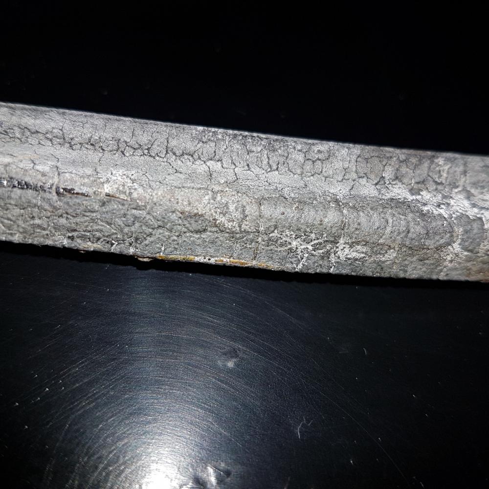

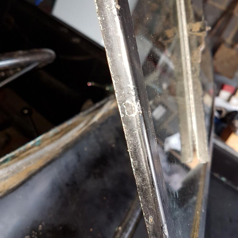

    So we now come to replacing the windscreen seal and discover that my RN windscreen is probably not original as there is no slot around the outside of the screen to accommodate the rubber. The existing, shot to pieces rubber, is actually stuck to the body reveal of the aperture. The windscreen section is a "U" profile black steel with no place to slot a rubber in. The existing rubber/spongy seal is as the picture section here. Now comes the problem, none of the suppliers that I have contacted, A7, Seven workshop, Woolies and Seals Direct, have this profile available. Anyone here have any suggestions, I would be most grateful.

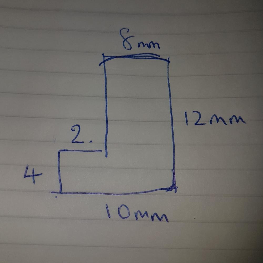

Can you get a flat 8mm x 12 mm section and using Tiger Seal / Sticks all glue a 2 x 4 section to it.

Looking at this link I am not so sure about mine being original or not now. Save to say there is no way of fitting the seal to the screen, it must have to be glued into the body, unless of course someone knows different!!
