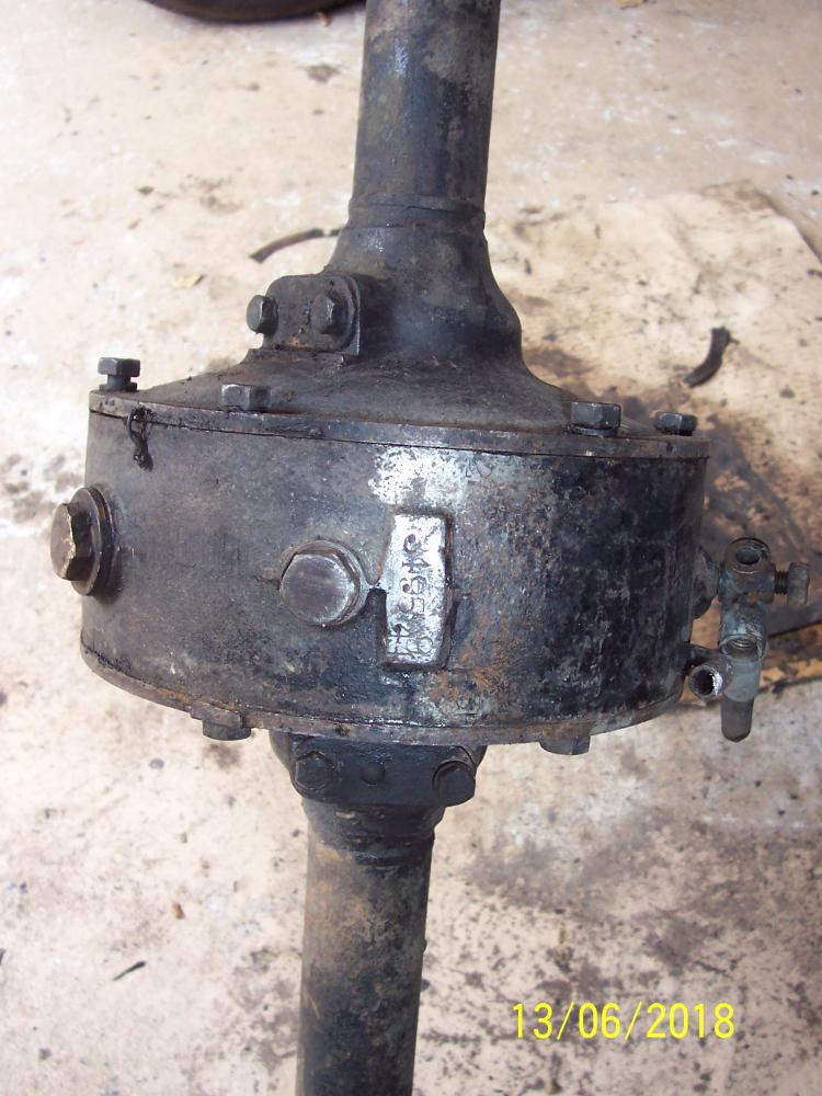

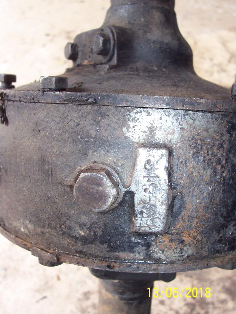

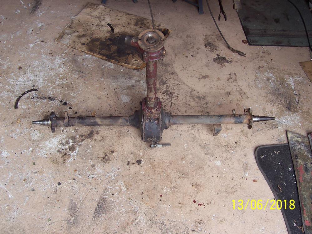

Photos of an AG axle. Any ideas about the numbers stamped on the casing? I think it is a Type 3 (page 164 green book)

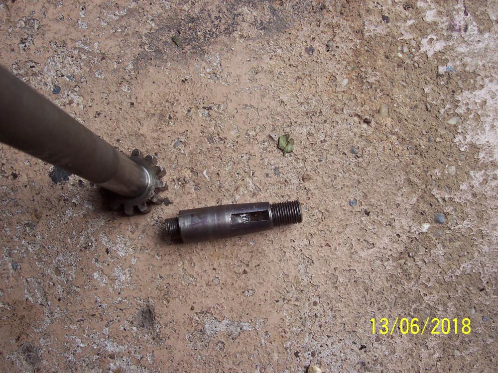

And the broken shaft with it's strange repair. Pity because the keyway is perfect!
The axle has currently got one long & one short shaft!
If you clean the paint away from above the number you have exposed you should find a date and the original ratio that was fitted into it.
The back axle was one of the last things fitted so the date can often give you a good indication of when it left the factory...
the axle ratio is at the end of the bit you have already cleaned... 9/44.
as R says, date will be above, the three sections quite widely spaced.

There is a witness of a number or so where you suggest. I'll get the wire brush out!
