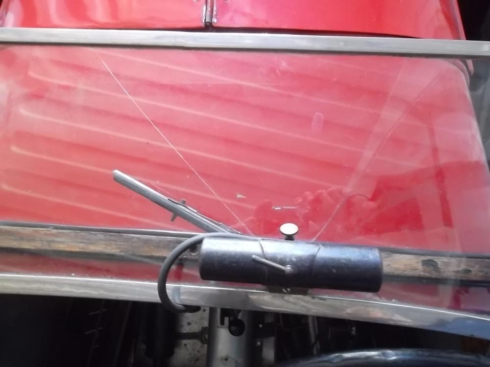

Thanks for the advice and I’ve managed to find a couple of leads for suppliers of classic car windscreens to follow up next week. Originally I had intended to cut my own from 6mm thick polycarbonate sheet thinking if it’s used to make canopies for fighter aircraft, most industrial safety glasses and track racing cars it should be safe to use for an Austin Seven if just more susceptible to scratching. That was before I found out that it’s legal on all other road car windows apart from the windscreen – don’t really know why?
The main reason I was going down the plastic route was that I suspect a new glass screen will fail in the same way as the existing screen which requires a cut out for the vacuum wiper where it has failed at the corners. Bigger radius corners required or I wonder if drilling a hole for the shaft rather than a full cut-out would be a better solution? Any other suggestions?

My special has had a wiper slot in the top of the laminated screen for 25 years with no problems. It has an Ulster style frame with no top part. I did take some care in rounding and polishing the edges of the slot as well as the long edge to discourage cracks; I don't know if this makes a difference.
It has had 2 identical screens in that time - the first having been smashed by a stone.
Peter.
S O-H, your wiper attachment is very interesting, it is the physical clamp that is causing the cracking issue for you?
Can you adapt it so that it clamps slightly lower down, onto the frame, instead?
Hi Bearded Wizard, I’m sure you recognize the car so you’ll understand what I mean when I say that the wiper  mounting is just one of the many “interesting”  design features which I’ve been deconstructing, reverse engineering and re-fitting for some months. I don’t think it’s the clamp cracking the screen, I think it’s the frame that’s a bit flexible but I like the idea of moving the bracket lower and making the mounting more robust.  Just off to try and get the engine fired up today so will give it some thought. Strengthening the bottom rail of the screen frame to incorporate a new wiper mounting might be a possibility.
