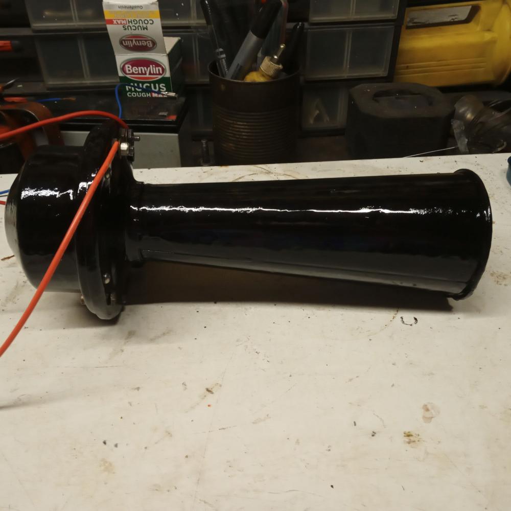

Completed repair of one Rist horn where the coil was open circuit, which meant a total strip down to unrivet the coil bobin, make a new bobin and wind the coil
is the Benylin a lubricant for the diaphragm to make the horn sound less like a duck with a sore throat?
