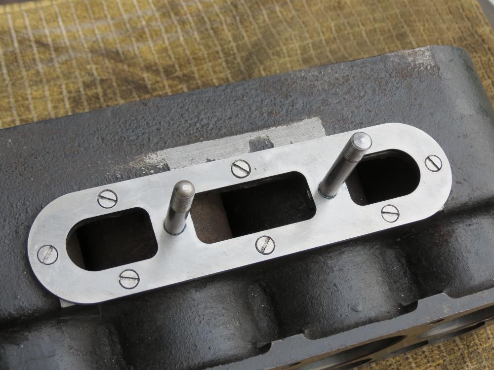

One of the water inlet manifold stud threads has suffered somewhat, as in below picture. Clearly this is going to be an area which suffers from corrosion. However, it also doesn’t take pressure. There doesn’t look like a great deal of material to take a helicoil and there is a decent amount of thread present, so recommendations appreciated, should I just use as is or attempt helicoil?
edit: there is more material than the close up image suggests, the shadow makes it look worse than it is.

The side water inlet can be repaired by using a stainless steel repair plate from John Barlow supplied with fixings, for fitting information see BA7C technical website.
