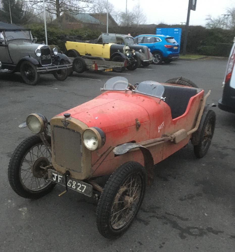

What I did this  morning  was marshalling on the Clee Hills Trial. A brief stop en route to the section revealed only one Seven in the car park of the Squirrel at Ludlow, number 58 entered by Rob and M Atkinson. Many Sevenists marshalling and as officials, unusually few Seven entries this year.
