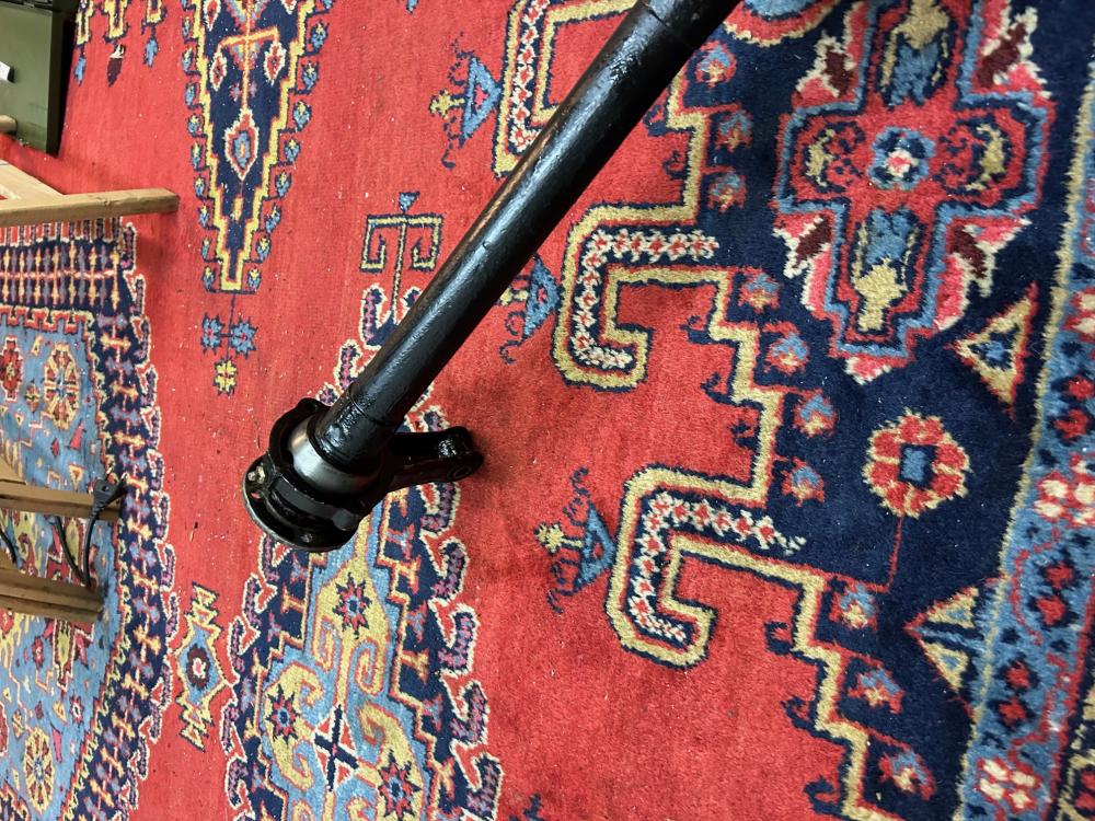

Fitting an axle in our saloons I sit on the floor with my feet facing forward and lift the axle onto onto my legs with the diff over my crutch and the torque tube front end supported by my feet I then shuffle it under the car using my feet to lift the torque tube into place followed by lifting the axle onto the springs when some 3/8" rods are used to hold it there. Wriggle out and have a brew.

I would love to see a video of Dave Mann installing a rear axle using his bum-shuffle method.
I like the carpet in Oliver's workshop. Very classy. It would make Dave Mann's shuffle a little more comfortable.

Works well putting the axle in single handed, and yes I have a nice piece of carpet to bum shuffle on.
