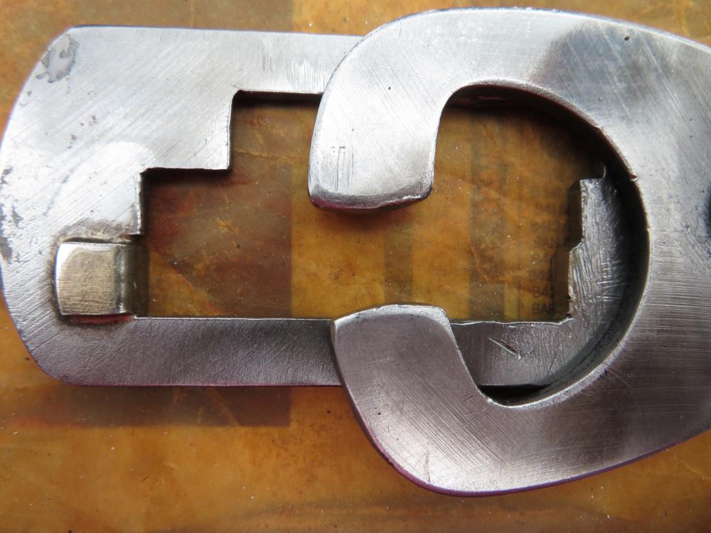

(21-12-2024, 01:54 PM)Terrytuned Wrote: The gearchange can over throw if the 1st gear slot in the swing plate is too long not stopping the selector fork, and exposing the balls. Once the selector fork has engaged the gear there should be no space behind it. Photo of stop s/soldered to take up space. Terry. I concur Terry. When this happened to me I was way too far from home to do a proper rebuild, the box was simply stripped, cleaned and re-assembled. But I did have Hescho (Bosnian mechanic who was helping) put a blob of weld on the gate to limit how far the selector could travel. In this condition we made it home from Switzerland, albeit with our fingers crossed. |
