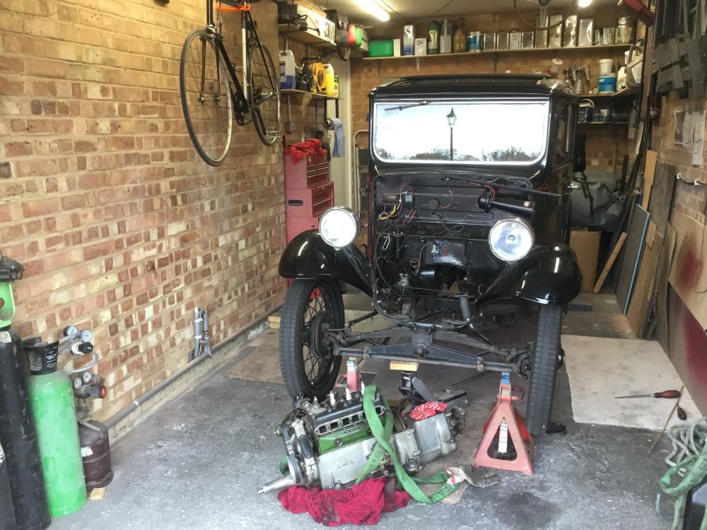

I remember the days when I used to have a foot on each front mudguard and a rope around my neck to pull the engine out…it would be out and on the bench in an hour.
Now, fifty years later, it takes me nearly all day and I need a quiet lie down!
Froze my nuts off today trying to free the engine on this nice Ruby      . It wasn't made easy by having a late HC head, I've put a good dose of release oil in each cylinder and will leave it a week while the garage key holder is away.
