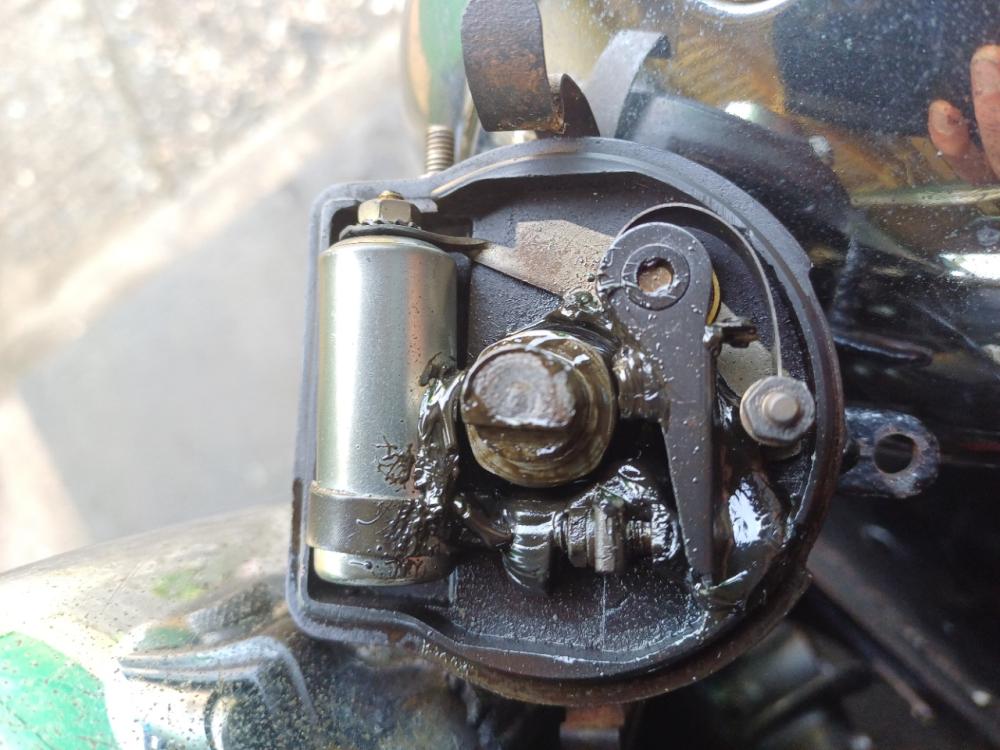

Drove the RP yesterday, no problems. This morning it would not start. A look inside the distributor showed why. I am amazed it ran at all yesterday.
Mental note to self: Do not overgrease the drive gear...

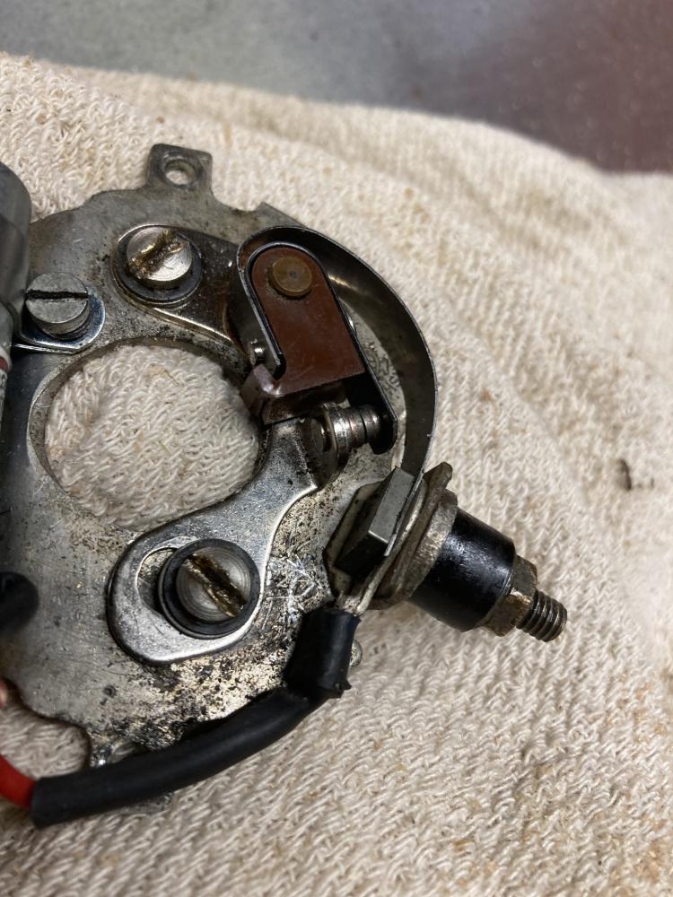

When mine wouldn't start this had happened.
Sadly it was a modern replacement part, less than a year old from a well known vendor (not an A7 specialist). Just poorly made from the wrong material.
Bought a new set from the Distributor Doctor that were made from the right, fibrous material, not just plastic.
