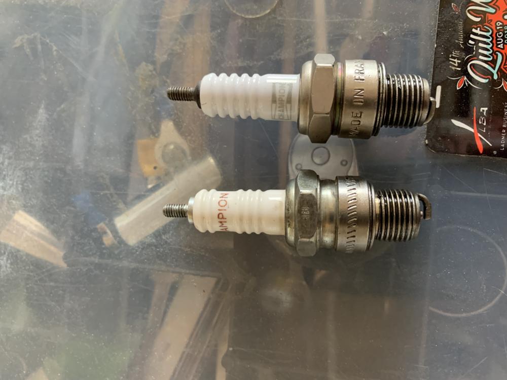

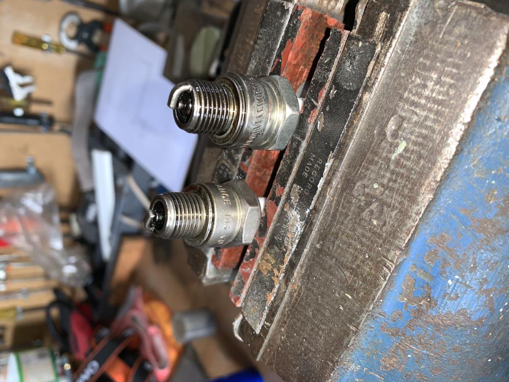

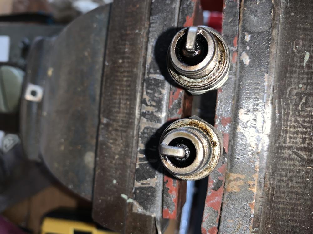

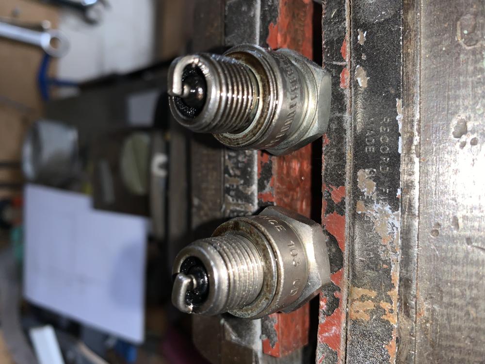

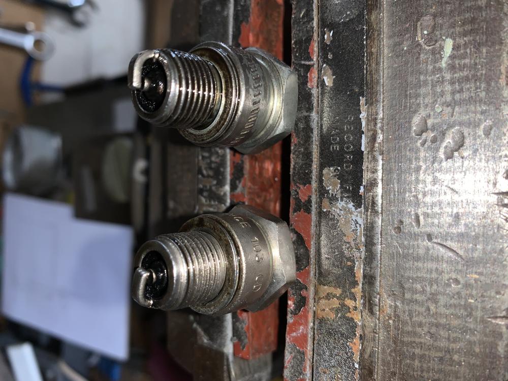

Here’s some pictures. Two different markings, different suppliers, but both very little use
There are 2 different Champion logos so they came from different suppliers I think.
Sorry, I double clicked, better too many than not enough?

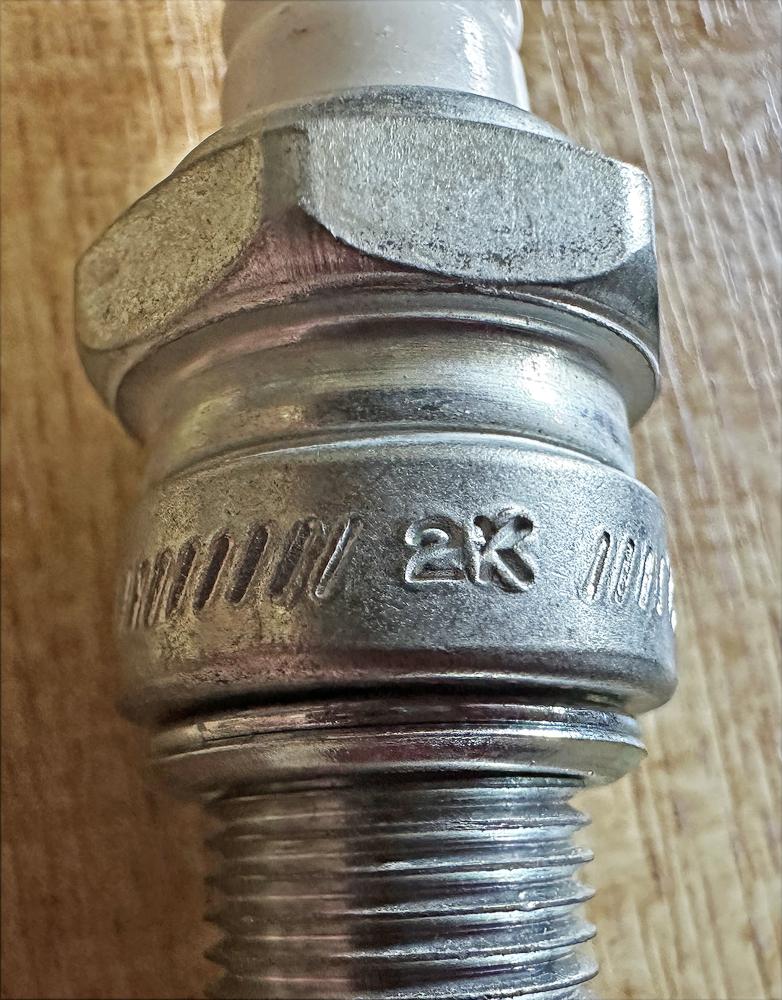

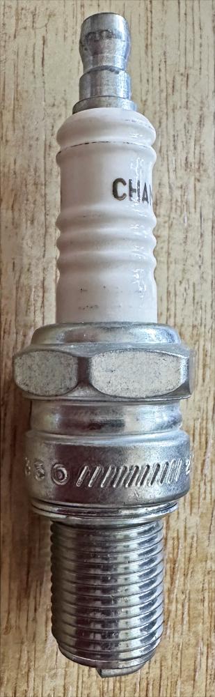

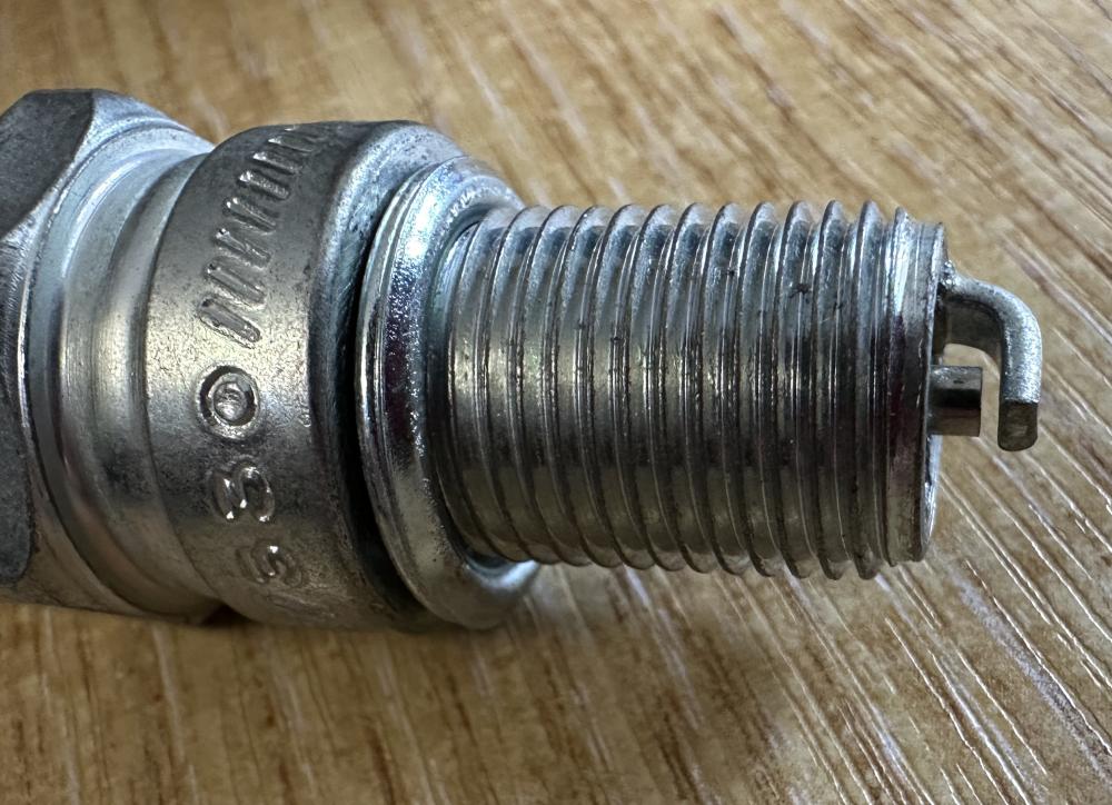

Here's the Champion box and plug that I received from the Green Spark Plug Company last Wednesday. They were out of stock of NGKs - I think they said that delivery was due early September - but suggested that this would be a close match. If Green Spark Plug Co. (who must order lots of plugs) has to wait months for delivery one must assume that they are the real deal. I hope this helps.

The plugs in your picture appear to be fouled.
Too rich a mixture or oil coming up the bore? Modern plugs do not have a shiny glaze on the inner ceramic part any more, once fouled you cannot clean it and the plug won’t work.
Thank you, I rather think it may be oil fouling but I’ll get some new and see how it goes.
Thanks again, an interesting video. BTW, not everyone knows that NGK is from BaNGKok.
Try running with a hotter plug.
I’ll try that Ruairidh . Cheaper 1st option than an engine rebuild!
