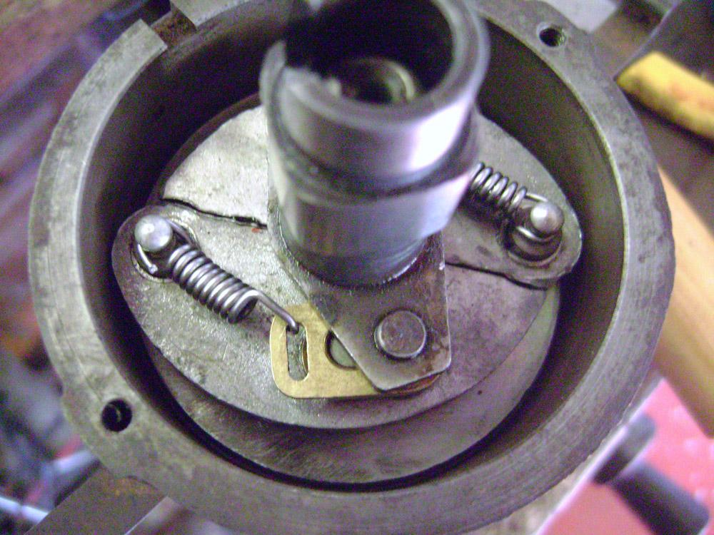

Does this look correct?
Just been looking at my DK4A distributor as the auto advance doesn't seem to be working correctly and I'm now not sure if this is the correct distributor as the internal details seem different to some of the illustrations I've seen on-line.
The main issue seems to be that there is very limited movement of the bob-weights and the springs don't cause the cam to snap back into position.
I've not dismantled it any further before being a bit more confident I know what I'm doing.

Looks about right to me.
As far as I know "The Distributor Doctor" is the only source of new springs.
At the same time you need to check for free movement without excessive play.
Beneath the weights is a plate with holes which limit the amount of advance - these are often either worn or the wrong size (there were many, many variants of the DK4) - this can be addressed by welding up and/ or filing.
At the same time check for play in the shaft - new oilite bushes can be obtained from the supplier above.
The Lucas dealer training notes used to be available online and are rather helpful.
I'll try to attach here if it will allow a pdf.

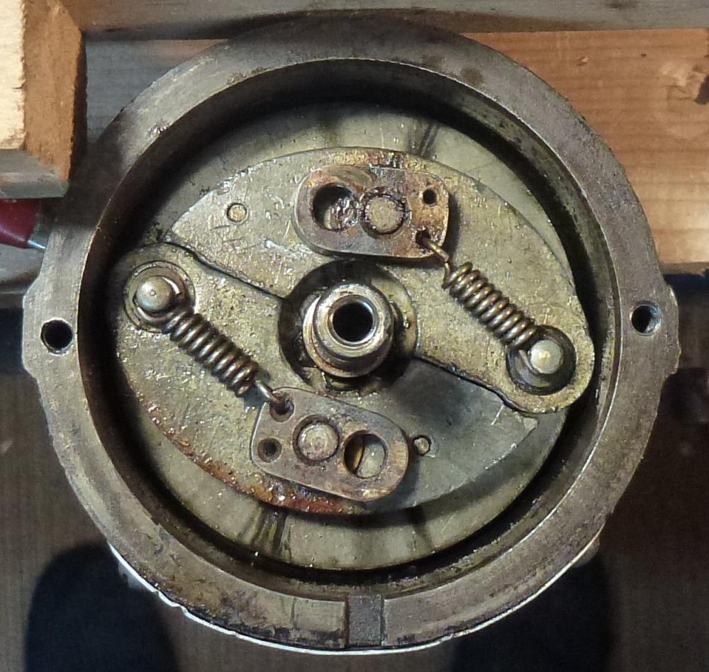

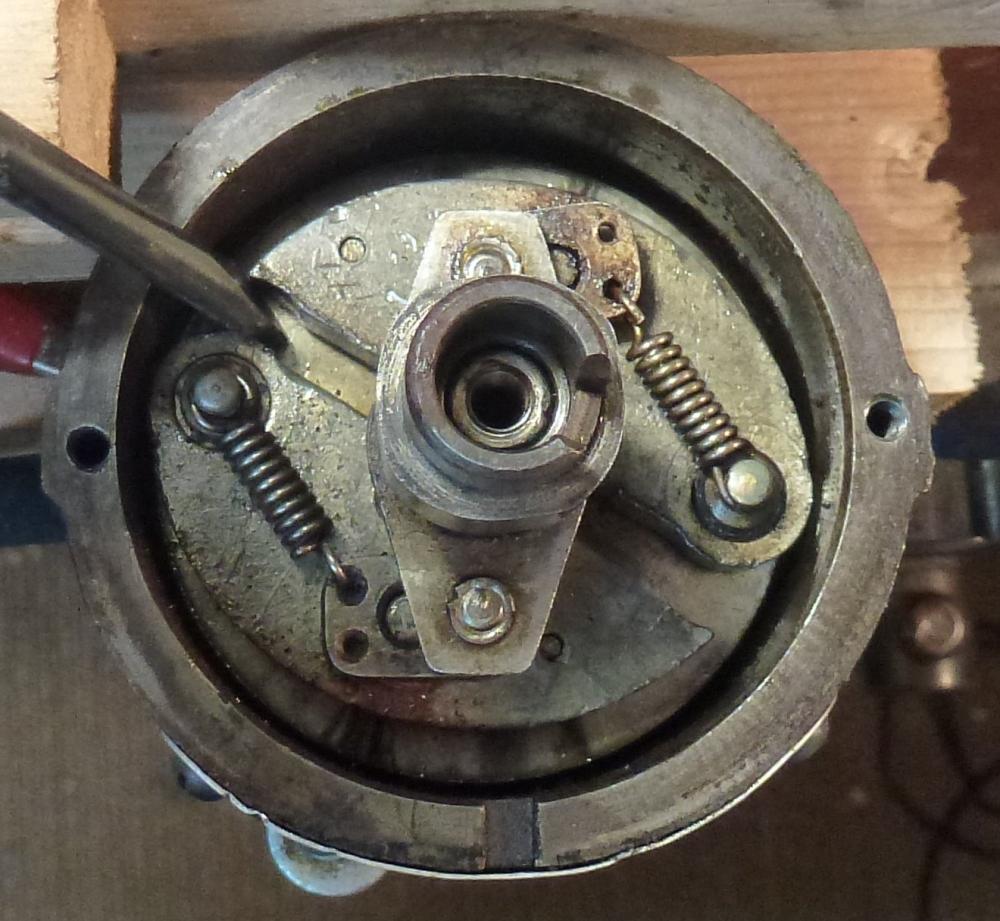

Hi
It looks unusual to me, the toggles seem to have slots instead of holes, I can only think someone has modified them but what they were trying to achieve is a mystery.  I believe the reason toggles have two holes is just manufacturing convenience, so that the same part suits clockwise or anticlockwise variants.  Only the inner holes are used for the springs.
The amount of elongation of the springs is tiny, especially when there is only a small amount of advance coming off idle.  This makes the design very susceptible to any wear.  A sign of this is weights that do not close together at rest, or can be pried apart very easily.  The static timing is then somewhat random ! Sometimes fitting slightly shorter springs (fractions of a millimetre) can compensate for wear.
The attached photos at rest and maximum advance are of my own DK4A which I recently overhauled.  The standard springs are identical and give a more or less straight line of advance with a maximum of 8 distributor degrees (16 crank degrees).  The limit is set by the movement of a peg within a circular hole in the action plate which I measured as 21/64 inch diameter (8.3 mm). Any wear/ovality in this hole increases the maximum advance.
Not modified John, just a variant Lucas part - here's one I did earlier (in this case I was experimenting with home-made springs - but I'm afraid I don't recall off the cuff which precise distributor part number it was).
Hi Chris
That's interesting - I haven't come across the slotted toggle variant before.
Checking back on my notes, the gap between the weights at full advance is about 3/16 inch (4.8 mm). The spring extension at rest is about 20 thou (0.5 mm) in other words not slack but not very stretched either.
The toggle geometry is quite clever. A plain spring acted on by centrifugal force would give an advance that increased with the square of the RPM - not what's wanted. The pivoted toggles compensate for this to give advance more or less proportional to RPM. I take my hat off to which ever mechanical designer dreamt that one up.
