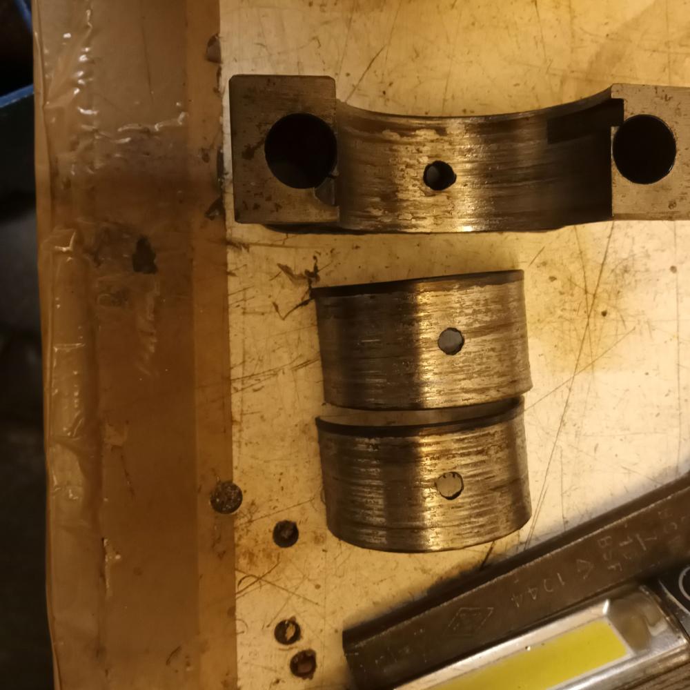

A local owner of a Ruby reported knocking from the engine and took the engine out, on opening it up he found that the center main bearing had failed.
So I advised him that the crank will have to come out for crack detection and probable regrind. I've no experience of 3 bearing engines what is the repair procedure for the bearing housing? Are new ones available? Are they fit and forget or does it need line boring? What is the likely cause?
Dave, this looks to me as if the bearing shells have rotated in the housing? - Hard to tell from a photo.
If so, the housing is oversize and the same thing will more than likely happen again with new shells.*
One way would be to fit a "new" (used) housing with less wear.
Unless axial alignment is checked though it's more a matter of "fit and hope" than "fit and forget".
If you want it bulletproof -
Machine a new top housing section about 1 or 2 thou larger diameter than the aluminium casting it fits into (so that it has to be pushed in with a little force). The inner diameter should be left 15 or 20 thou undersize.
Skim the joint face of the lower housing about 10 or 15 thou.
Ideally convert the casing to take bolts from below (then the joint is independent from the block fixing).
Then torque up the housing bolts with the block in position and have it line bored by your local engine recon shop.
Mark parts orientation so they can only go back in the right way...
* p.s. something I've seen before is a well intentioned person line-bored the housing, but failed to appreciate that without a machining allowance you simply end up with an oversize, oval bore... There has to be some metal there (on both sides) to machine.
Yes the bearing shells have spun in the housing. My only experience of dealing with this problem is on large 15" journals and there the solution was to fit new under size housings and line bore them.
Yes, shell bearings rely on a certain amount of 'nip' or crush occurring when the housing is bolted up to prevent rotation (the lugs are purely for alignment during assembly). If this has not occurred either the housing wasn't done up tight, or it was slightly oversize already. Or conceivably something was trapped in the joint (e.g. misguided insertion of a shim).
A swap for a better s/h housing might do the trick, I'd still check it for alignment though.
There's plenty of meat on the lower housing so it can be re-bored if you machine back the joint face a little - but the upper requires a new part with machining allowance added.

It looks like the shells did not have the locating tabs.
The tabs are usually carefully ground or filed off as they don't match the recesses in the housing (obviously they might if you happen to have a serviceable 90-year-old Austin set, otherwise the options are rather limited).
But - I'll say it once more for good measure - the tabs are only for alignment during assembly. It's the "nip" of the housing which stops the shells rotating in service.

Am I correct in thinking that the bearing housing is split at mid height. Each bearing shell is 1/8" short of filling the bottom half housing something I wouldn't expect.

(17-06-2024, 07:42 PM)Dave Mann Wrote: Am I correct in thinking that the bearing housing is split at mid height. Each bearing shell is 1/8" short of filling the bottom half housing something I wouldn't expect.
No, the split is slightly above the centreline so the top section is "short" and the bottom section is "tall".

The common shells which will fit more or less straight off (it's a given that tabs may need to be removed and oil holes re-drilled in the right place) are AE/Glacier M3333M, Reliant 92627, or Vandervell VP91162. With a little more work, Mini 850 shells can be reduced in width. Jamie and David still keep some stock I believe.
