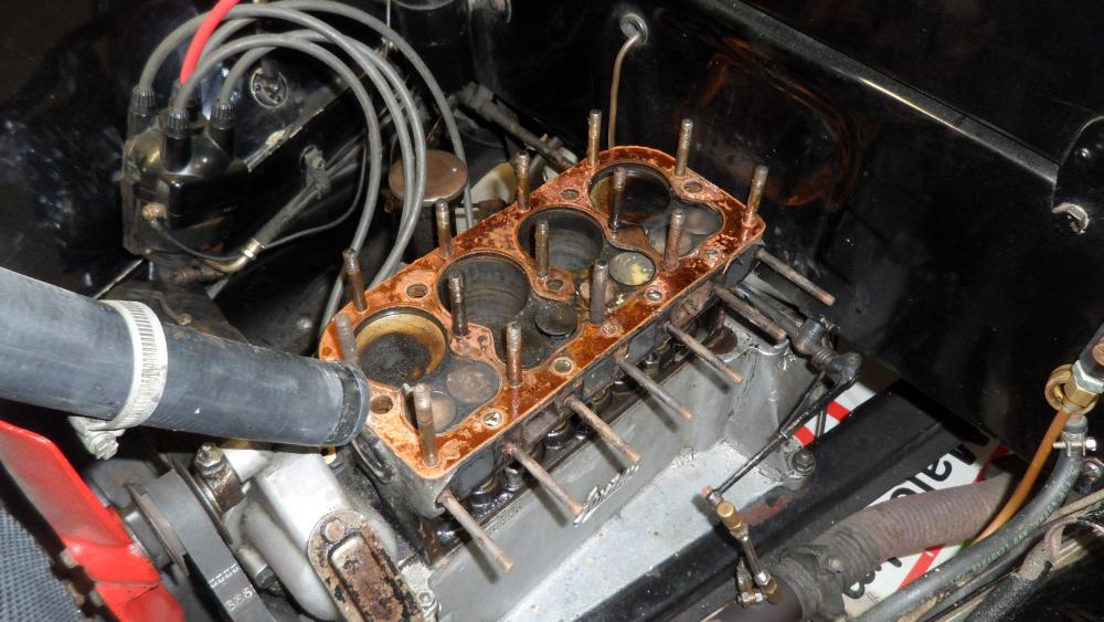

Today, having returned from a short break in the Lake District, I decided to have a look at the engine in my RL saloon.  I was on my way to the VSCC hillclimb at Harewood last Saturday when it suddenly developed nasty noises 5 miles from home.   Opening the bonnet there were exhaust gases coming out of the carburettor and everything suggested a problem with a valve to me.  I managed to limp home requiring first gear for some of the hills.
First job today was to remove the tappet chest cover.  Before doing this I took the manifold off complete with carburettor.  There was some coolant water in both the valve chest and some of the ports in the block.
The valves all looked okay (I had forgotten that it had double valve springs) so I checked the block nuts for tightness, all okay.
Next off with the cylinder head, a Ricardo aluminium head fitted to the car in 2016.    This revealed that the head gasket had failed between the exhaust valves of cylinders 2 and 3.  In fact a sizable piece of the gasket was missing.

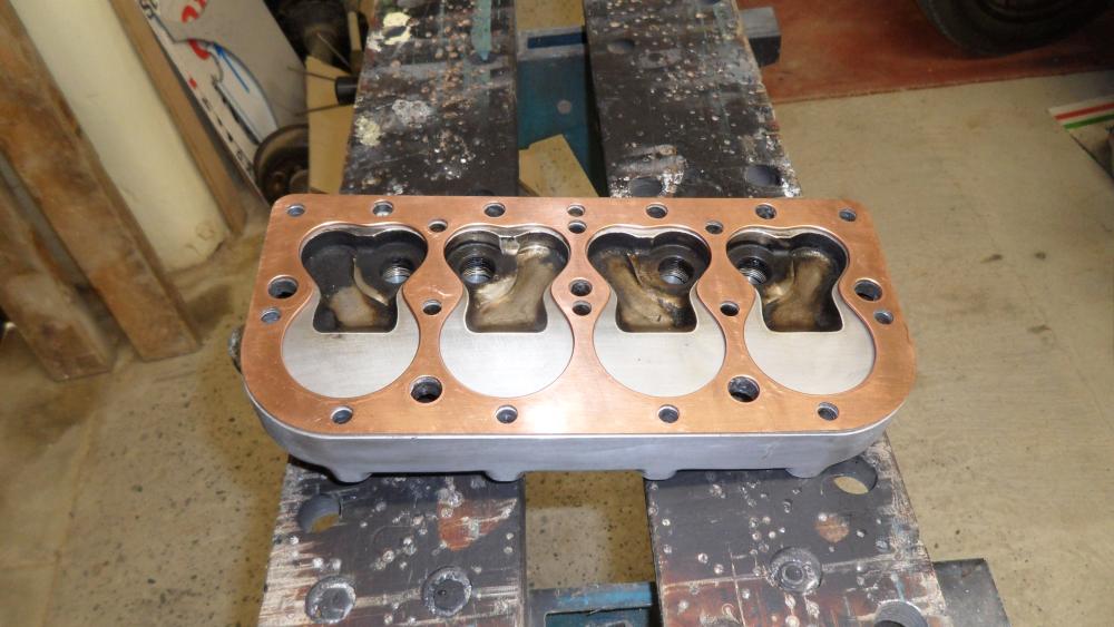

There was some water in the bores of cylinders 2 and 3.  Everything was cleaned up, the valves given a light wire brush and a new gasket fitted.       The previous one was a modern copper sandwich type from one of our cherished suppliers but the new one, bought last year, was noticeably heavier and seems to be of better quality.  I gave it a thin smear of Loctite copper silicone each side.  I also sprayed the manifold with Lidl heat resistant black paint (worth getting when they have it).
As you can see from the photos, the cylinder head is stained black where the gasket failed which suggests that the problem is long-standing.      I suspect that the problem may have started when i was on my way to the Centenary Rally back in July 2022.  Driving down in 40 degree heat the radiator overflow became detached and the engine (and me!) got very hot indeed.   The car has gone well since but for the last year has been rather unwilling to start, unusual as over the last twenty-some years it has always started without any bother.
Having fitted the new gasket the engine started without any bother and it sounds like it should do.       Tomorrow I will take it out for a decent run, weather permitting.

(15-06-2024, 03:04 PM)Malcolm Parker Wrote:   There was some coolant water in both the valve chest and some of the ports in the block.
Malcolm - what do you use in your coolant? - that head looks mighty clean.

For coolant I use good old fashioned water which by virtue of an old deed of 1880 we get free of charge in Boltby where I live.
I have tried antifreeze in the past but find that it develops gunge.  I drain the cars down in winter and run the engines for several minutes until steam stops coming out of the radiator cap.    When I drain the water for routine jobs it is generally very clean when it comes out.   The Ricardo head is one of Dave Dyes and is of good quality aluminium.   There was a bit of light corrosion around the top outlet but nothing to worry about after several years use.  I wiped the cylinder head with a cloth dipped in white spirit which removed most of the light carbon deposit in the combustion chambers.  Then I gave the face of the cylinder head a very light sanding with fine emery paper.  The engine runs on an SU and goes very well so the mixture can't be far off.   Whilst I don't want to be changing head gaskets on a regular basis it does give you a chance to see what is going on in the engine.   The tops of the pistons were also very clean for 25 years of running, only needed wiping with the cloth to remove the oily carbon deposit.   I only run the car on Tesco Momentum or equivalent.

If you've bought the engine I think you have (and Malcolm does as well) then I think you have a very good unit that was a bargin price given what it would cost to build one from scratch particularly to that spec and standard. I was with someone yesterday who wanted to buy it but was beaten to it. He was most disapointed.
Today I torqued the cylinder head nuts down to 20 ft/lb, filled the radiator with water and went for a 60 mile scenic drive to Malton and back, dodging the odd cloudburst.  The car is back to its former self, cruising comfortably at 45mph with 50 easily available.   On getting back home I retightened the head nuts whilst the engine was hot.  I was very pleased to see that there was not a drop of oil on either side of the crankcase after some quite hard use.
