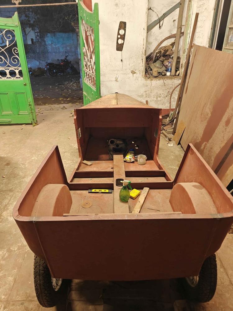

Hi everyone,
I know I've been missing for several months now but I had few projects come my way to keep me very busy, so the poor Austin had to be on hold for a while.

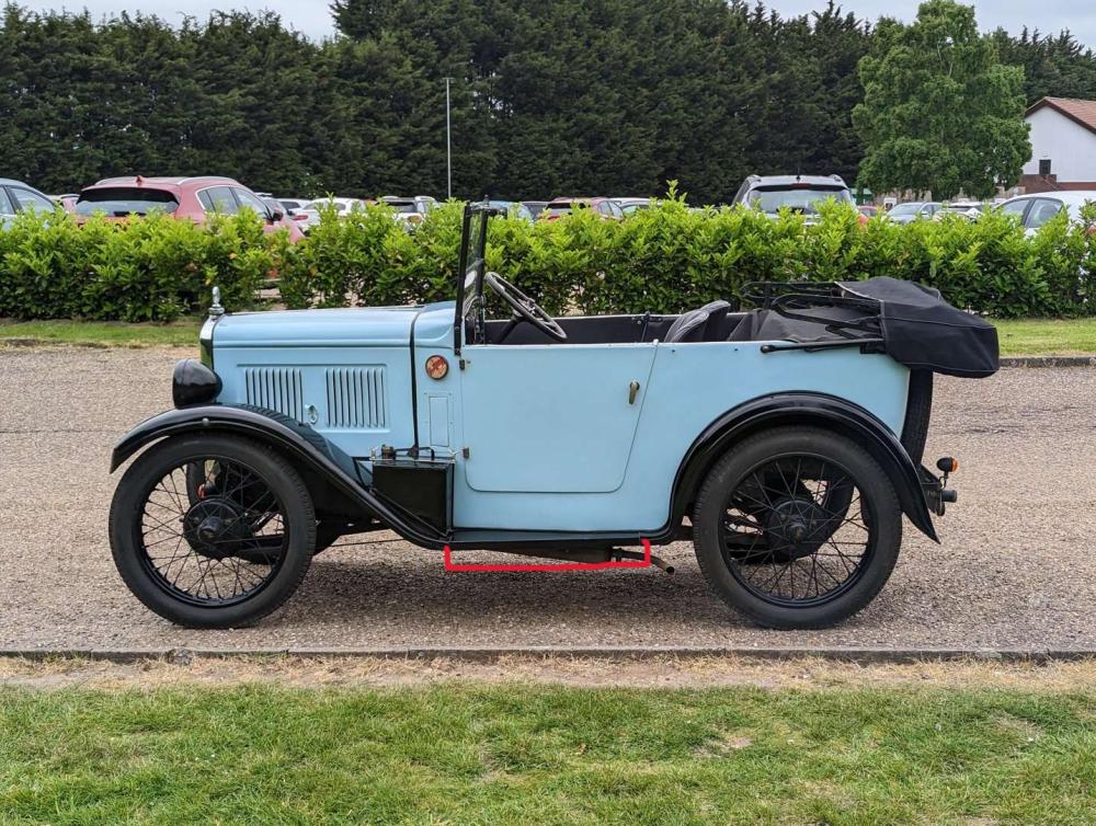

We're back working on my 1931 Austin again, making an all new body tub. I needed some measurements and would be grateful for help.
1) Width of the flat part of the front wings, towards the front
2) Width of the flat part of the rear wings, towards the rear
3) Length of running board
4) Width of the front part of the running board
5) Width of the rear part of the running board
The old panels have been altered several times in the past and I can't go by what they measure.
Attaching 3 pics of a lovely light blue ref car (1930) where I've highlighted the areas I need in red.
Also, a few pics of my car currently.
She's finally back on 19 inch wheels which I brought in from the UK (I got her with 17 inch wheels).
Thanks & regards
Prithvi
I have a particularly unpleasant  punishment for people who mutilate Austin 7 wings  Big Grin
Hello Prithvi, It's rather challenging to give you exact measurements because the front wing surfaces are curved, and the rear wings curved at their edges. The front will be around 130 to 140mm and the rear 140mm. The running board is 645 mm long. I hope this helps.
Thanks a ton, Tony!
These measurements are from your AF?
