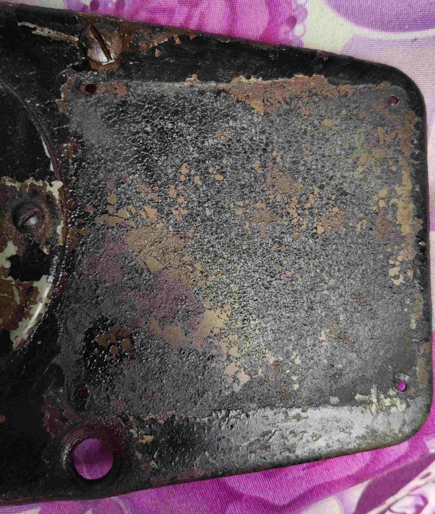

I was reading with interest a thread on the forum about the original finish of the dash panel on the AG tourers and was surprised to see that some of them had a 'crackle' finish and so I decided to take of the patent plate on my car's dash panel today and, well, I too found a crackle finish!
My question now to the gurus is - how do I replicate this finish?
Have a look at the pic of the finish behind the patent plate on my car's dash panel.

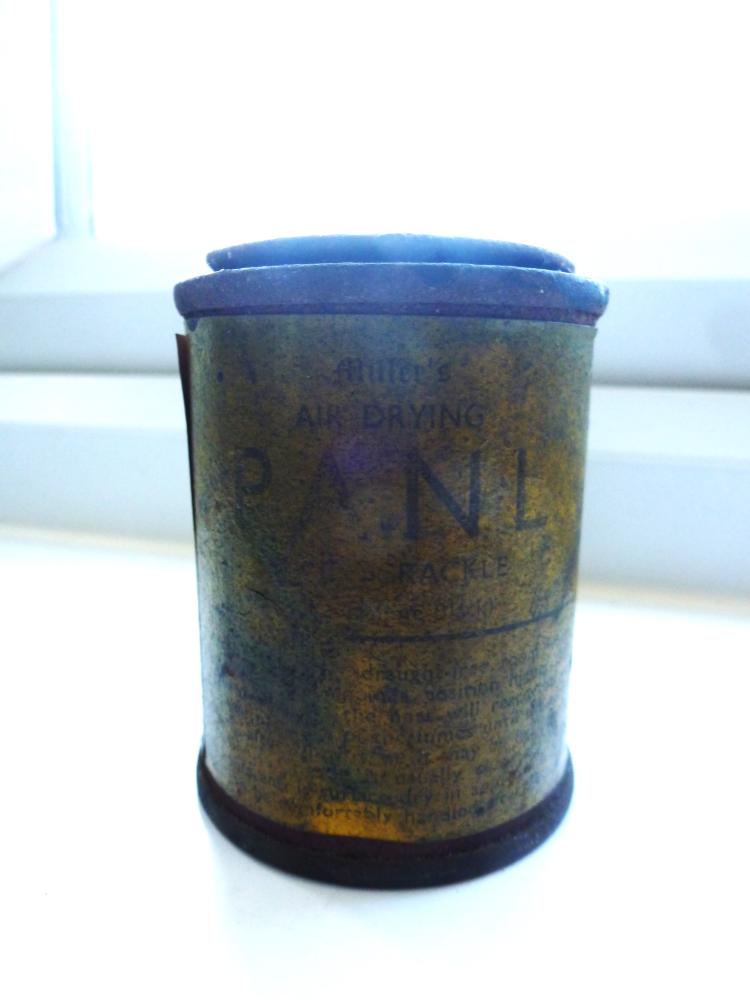

As you say, the correct finish is a crackle paint. I was able to replicate it on my AG with an ancient tin of 'Miller's PANL Air-Drying Crackle' paint which I inherited from my late father. I think it was used on pre-War radio sets, so it might be worth investigating a modern source via radio enthusiasts. Failing that, I still have the tin of paint which I can't see ever being of use to me in the future, so you are welcome to it - but be aware it is probably now the best part of ninety years old! Although described as air-drying, the crackle finish is improved by drying in a domestic gas oven for perhaps half-an-hour; I think the moist atmosphere helps!
Alternatively, you should be able to source an aerosol can of wrinkle-finish paint which was used, amongst other things, on MGB dashboards - not a perfect match, but an easy solution.

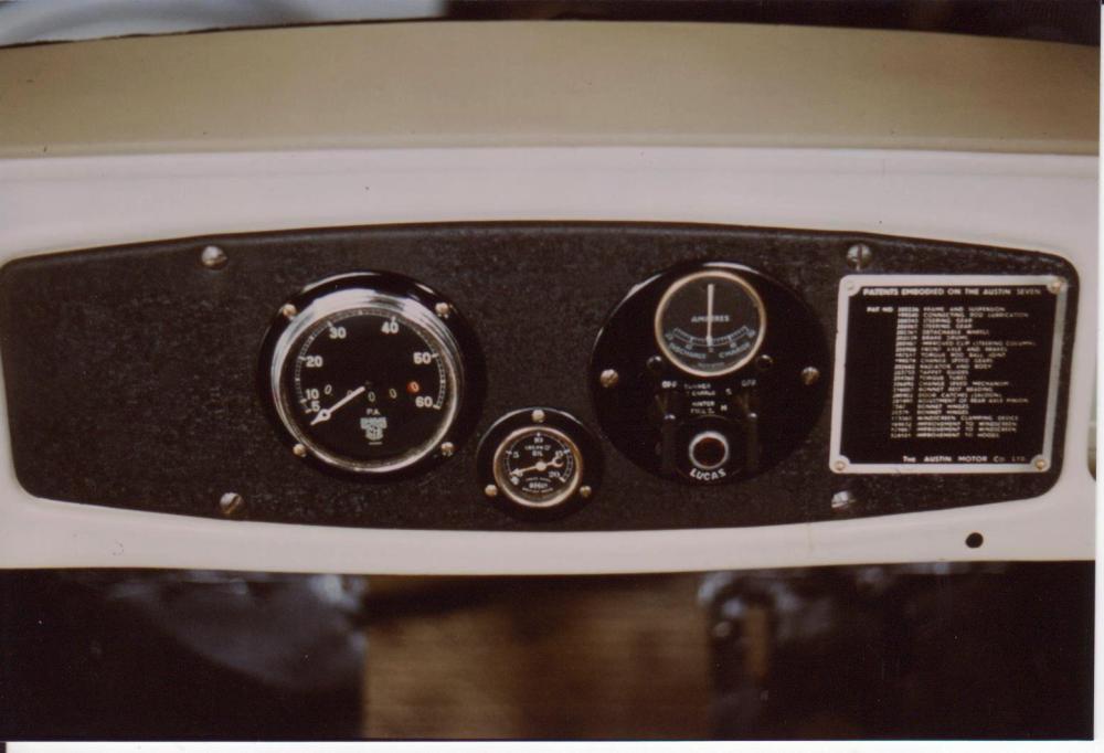

I used an aerosol can (well two actually). But it took about three attempts.  It worked best when I put the freshly sprayed dash in bright warm sunshine!
.jpeg   IMG_0514.jpeg (Size: 100.85 KB / Downloads: 167)
