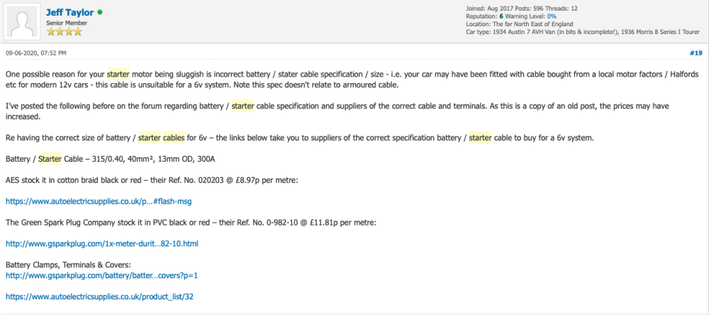

Hi Denis,
I've posted this a number of times in the past regarding the best cable size for 6v systems - suggest you check yours, if they're cables designed for 12v systems then they won't be thick enough. I've used the cables specified below on my 6v 1936 Morris 8 Tourer.
Jeff.

After far too many days spent faffing around trying to get the starter to turn over, I finally managed to work out the problem, all of my own making I might add. Many thanks for the very useful advice from one and all, it all boiled down to insufficient cable diamater from the battery. Once enough cable diameter was provided she turned over as she had always done fitted in the car.
