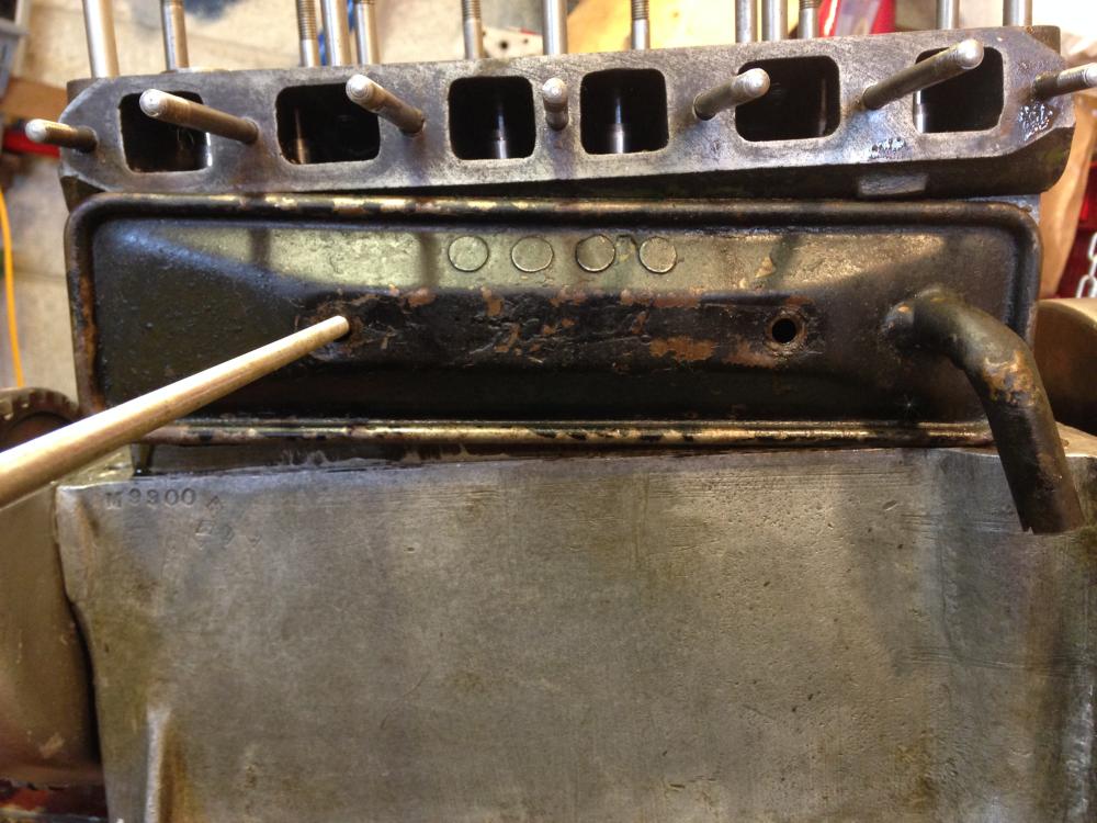

What I did this afternoon was say some rude words. As part of offering everything up before bolting the engine together and dropping  it into the machine, I tried the valve cover. Could not the knurled screws to line up, no amount of gentle juggling worked. Finally decided that serious research was required, so screwed in some threaded rod to slide on the valve cover. Which immediately showed that the holes in the cover did not align with the bosses on the block, being significantly higher. Was this just an odd  valve cover recently unearthed from the "stores"? The answer is no. Another cover was also rejected by that block, and both were quite happy when offered up to the spare blocks littering my stores as much as everybody has some blocks. So why, and how many, blocks have different placed holes, and is there a suitable valve cover easily to be found.
Early blocks had the valve chest cover studs in a different position to later blocks with specific valve chest covers for each type. You've got the wrong cover for your block or the wrong block for your cover.
We live in a small world, so as well as distinguished competitors responding to comments, photos are sent all the way from Shropshire  by email. Early blocks do indeed  have  locating holes in a different position. So now all I have to do is find an early valve cover. Any out there?
Hi Steve
Early valve covers are also a different shape. They don’t have the rebate for the rubber gasket strip. Instead a flat cork gasket was used.
Your later cover would provide a better seal (using rubber) and I’ve used a later cover adapted by extending the holes on my special. Others may throw their hands up in horror at this modification or point out the downside of doing this.
I made two small steel strips to move the holes downwards on an early block so as to take a later cover.   They were simply small pieces of 1/8" steel about 1/2" wide and 1" long with two holes, one for a screw into the block, the other hole tapped to take the valve cover retaining screws.  I used a Reliant cast aluminium valve chest cover with the Reliant name filed off.  I am using a cork sheet gasket and it is oil tight.
