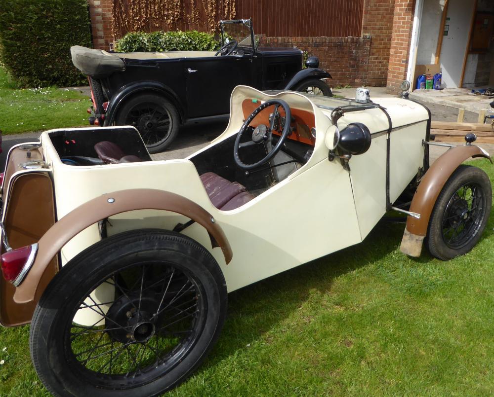

I offered to let someone tinker with Austin 7 stuff, to see if they would enjoy doing so.
Which meant I had to get "Slack Alice" out from long term storage, to put alongside the Tourer.
Which I was reluctant to do, because driving Alice has been a truly miserable experience, the couple of times I've done it over the last year or two.
Will start on ancient fuel, idle ok, but won't rev and when you insist that it does rev, runs erratically on three.
So, amongst other things, the lad changed the plugs, distibutor cap, leads - still the same.
"I really hate doing it, because it's a real fiddle, but, since you're here - you can watch me change the distributor " say I.
And - YIPPEE! - I have got my car back. Smile
The distributor drive gear is about a third chewed away.   Which must be what the problem was?
This was a new, brass, gear bought some time ago.   Done no more than five hundred miles, I guess.
Are new ones now any better?

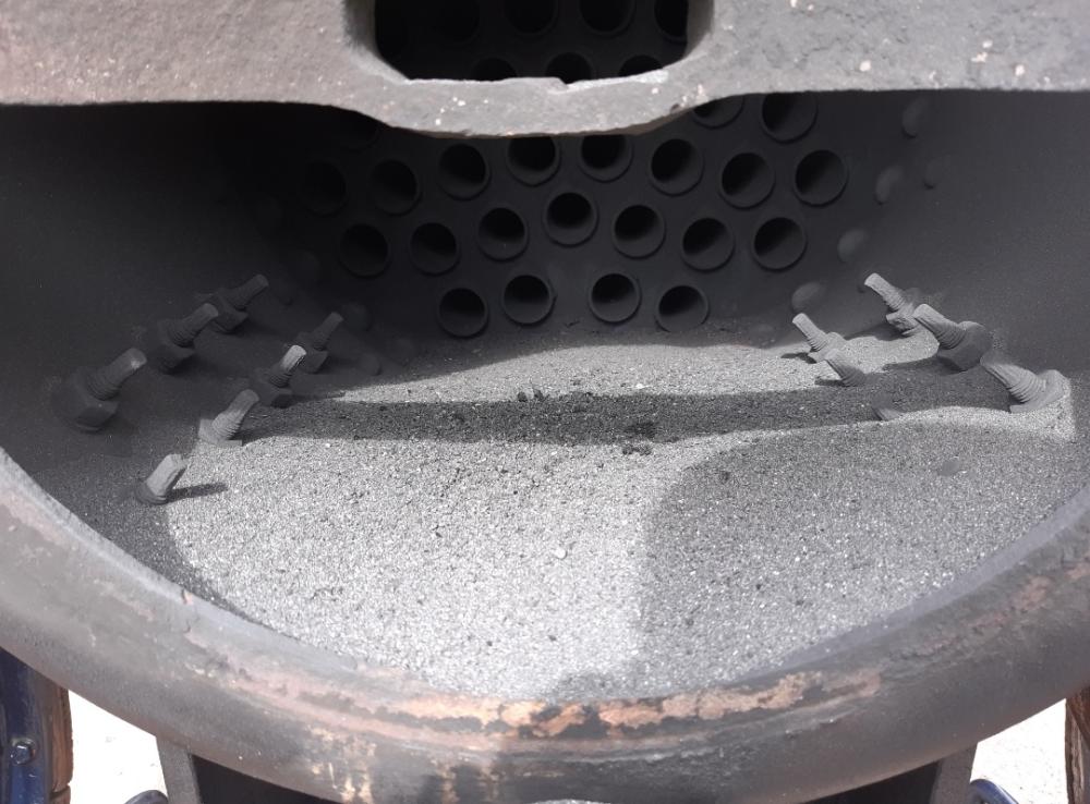

This stuff isnt as economical as the normal coal. I get perhaps another mile per 20kg out of that, not that I can buy any mind.
Most manufactured smokeless is totally unsuitable for our use unfortunatley. The ash fushion temperature is too low.
I'm not so sure about ash, certainly in the ashpan, but it looks like I found a source of shot blasting grit. Pity I havnt got a shot blaster
I have to be carefull where I park the engine in the shed, if i park it under the Cup im worried ill set fire to it.
